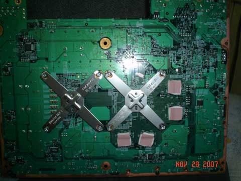

a x-clamp is.....
the badly designed system for holding the heat sinks on your xbox down to the mother board/GPU/CPU
there a bit flimsy and dont do a good job hence why we replace them with big fat bolts through the main cage of the box.
this the underside of the motherboard showing the x-clamps...
(i ddint take this photo, we can thank google images for it....
