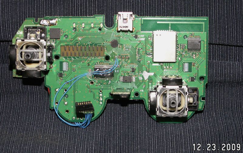

D-pad insides installed and wired up. Still have to do something about the stick opening, but as far as function goes, there she is..
http://s50.photobucket.com/albums/f320/RDC...nt=PS36D008.flv
I don't care much for messing with bondo/paint, so I went with transplanting the stick opening from another controller over the original D-pad opening.

Ah right coool stuff - Do you have any internal pics of this?
  • Posts: 2640
Re: PS36D, Left Stick and D-pad Swapped on PS3 Controller
« Reply #4 on: January 12, 2010, 10:27:09 AM »
Not many, when I get to working on something new the last thing I feel like doing is stopping to take 10 pics of it until I get one good pic of it that I like. ;)
There was a good deal of altering the shell internally as well as the brace that holds the Daughter board that I don't have a single pic of, but these pretty much cover what was done with the board.
As far as the D-pad went, it's really the same deal as how I make the 36D controller up, just a little more precise since it's fit into a smaller area.
http://forums.xbox-scene.com/index.php?showtopic=655017
I'd also like to mention that nothing was sacrificed function wise to make this swap, the D-pad is still Analog, no Tact switches were used, Rumble is still in place, it just has the Stick and D-pad swapped is all.

The PS3 controllers are a right PITA to do some things with, Sony's design is just jacked up and makes for doing something simple like swapping X and D-pad Down a right chore. This really wasn't too difficult at all by comparison to some of the controllers I've done up, but it was still interesting to see finished up.
