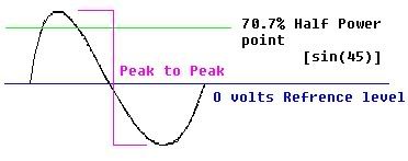

If you look that the schematic above, the voltage is shown in RMS and a new form called P-P which stands for Peak to Peak voltage. An AC sine wave have two polarities that are never simultaneously on ether 1 or the other because it flows in an elliptical motion.
In reality this sits on the x-axis of any plane horizontally, impedance however sits at a 45o between a y-axis and x-axis. The half power point is 70.7% percent of the P-P wave to get RMS.
Volts RMS = Volts P-P * .707
- or -
Volts RMS = Volts P-P * sin(45)
Just the Opposite...
Volts P-P = Volts RMS * sin(45)-1
- or -
Volts P-P = Volts RMS * 1.414
Ya Digg?
Check this Diagram of an AC wave:
To find the impedance of a circuit (Z) you have to do some Pythagorean theorem to find the phase relationship to convert real numbers and imaginary numbers together.
Impedance Formula:
Here is Proof of the impedance on a graph:
