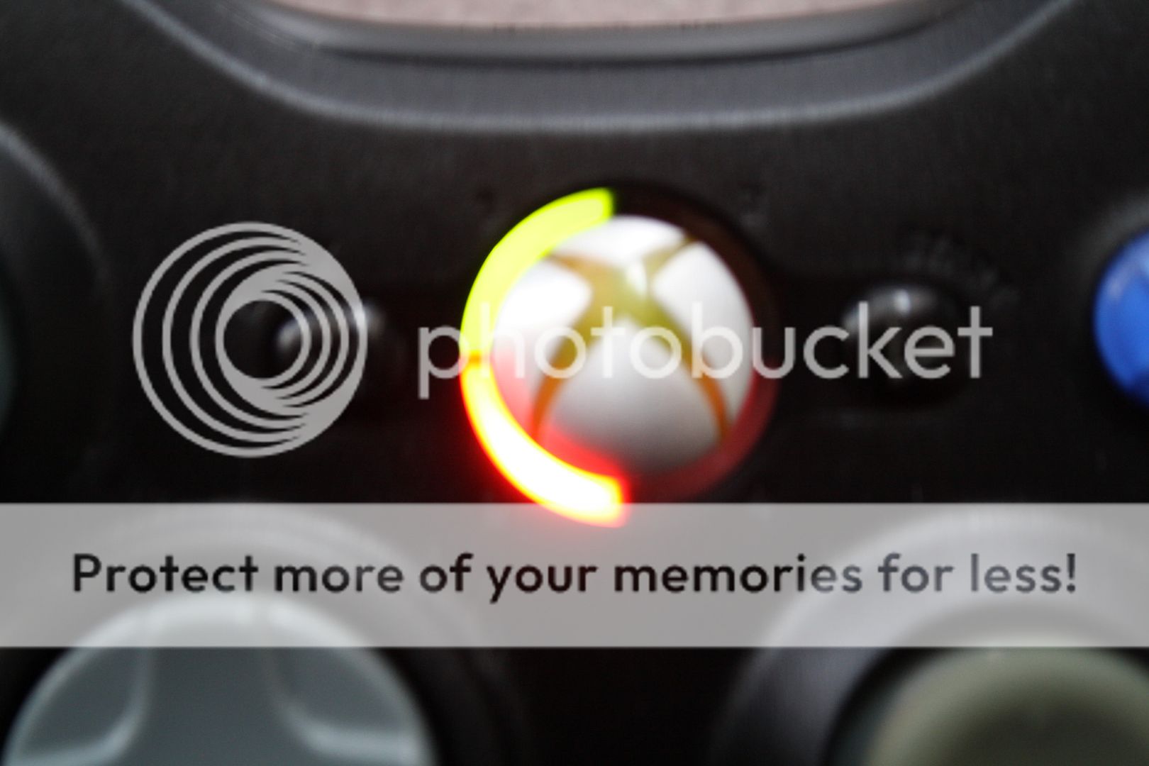

UKSYLER this picture might help you out with your button issue...
see as hazer says
For most tacts, if you bent the tacts flat so they are 90 degrees compared to the button, the two prongs pointing the same way are the ones that are open to each other. Maybe someone else can find a picture to show this better.
Spurgurgle d.t com
