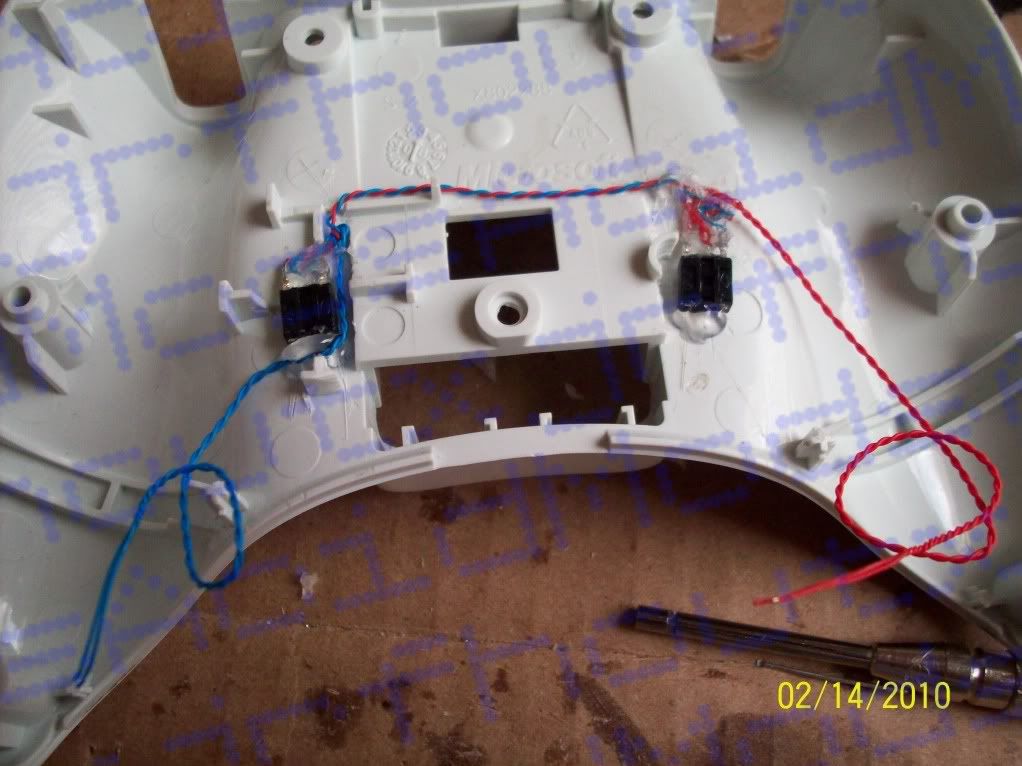

t0pfire installed... RF switches on the back, soon to also be custom shelled :) You can see that I recessed the holes for the buttons to give it a bit of a nicer feel, as well as the white and yellow wiring for the left trigger of the RF install.
Wire twisting keeps everything neat, clean, stays low profile, and looks cool, too (at least I think so)... Sometimes it can be a bit of a pain to do, like the red and blue twisted section below... but the look can pay off in the end.
Wiring and placement of RF switches, keep it clean, keep it clean!

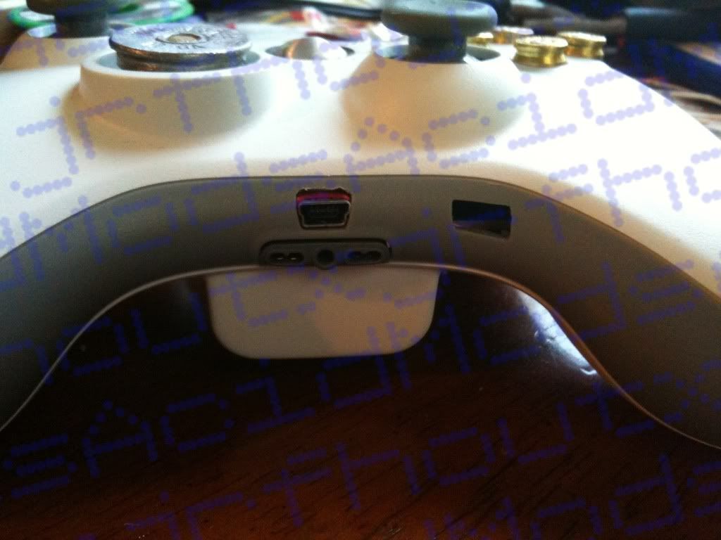

 Here you can also see a miniUSB connection for another project I've been working on... The miniUSB needed to be shrink-wrapped to keep it stable and keep the wires from breaking the solder connections. The controller trim also needed to be modified to allow the port to sit at the proper angle and not interfere with anything (like the headphone/keyboard port) as well as provide support and stability for the port and wiring (and also someplace to apply glue once the port becomes permanent ;) )...
MiniUSB port placement. In this pic you can also see another cut out in the controller trim panel. In the near future i'm planning on adding a miniUSB port for in circuit programming of the RF PIC, so that I don't have to open the controller and desolder the PIC when I want to update the RF code.
All gaps in the miniUSB ports will be filled with bondo or some other kind of filler once they have been glued in place and I'm prepping for paint...
