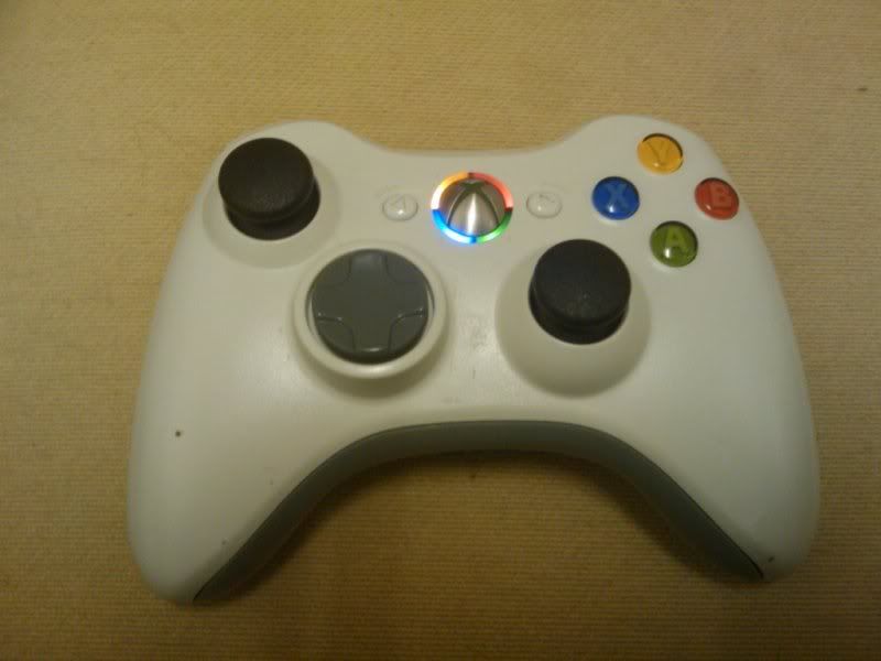

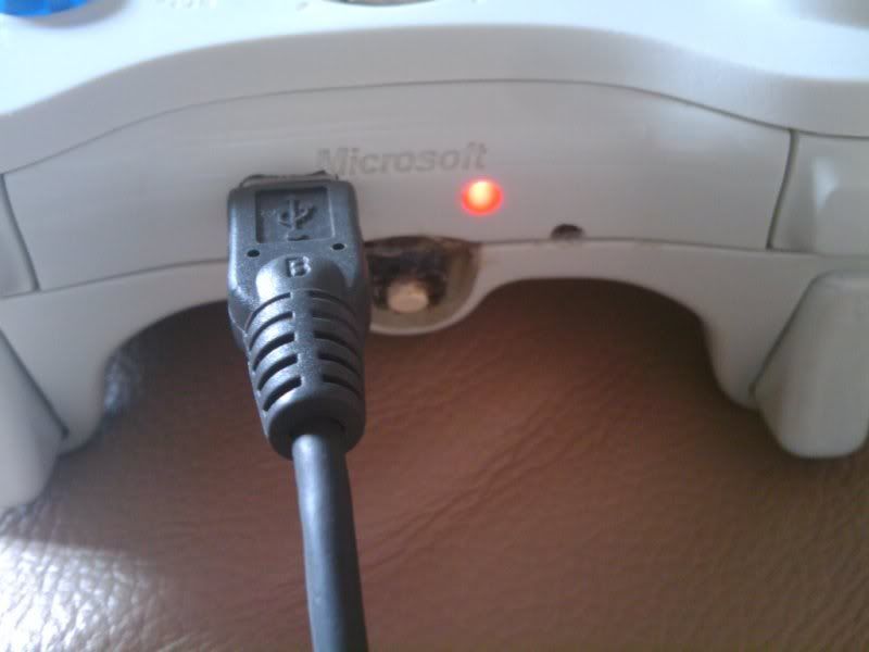

Check out my latest mod I just completed.
Looks like a normal controller with a play and charge kit.

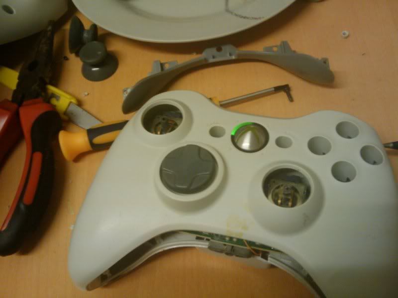

But flip it over and you see its in the shell of a wired controller (batteries relocated to where the rumblepacks were)
Also you'll see the IC chip. Contrary to the norm I've fitted an external socket to allow easy removal of the chip so I can reprogram it with any new code releases in seconds.
Lastly you can see where the wire used to come out I have fitted the tactile switch for easy switching and programming of the rapid fire modes.
Let me know what you think.

looks good, post up some internal pics! you used the microsoft play n charge battery right?

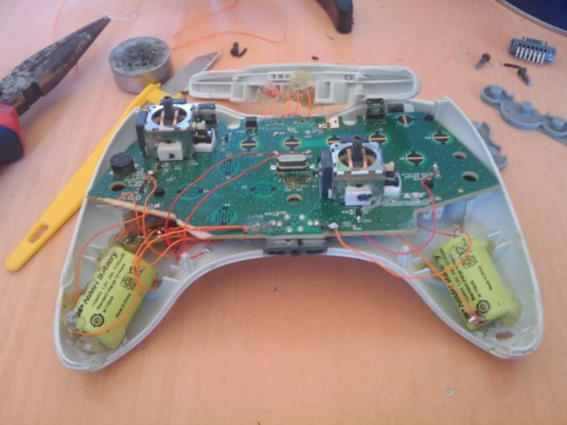

Ok, here's some more pictures
Works a treat, I've coded a chip for MW2 and one for WAW, just need some way of storing the chips when not in use.

Ive been looking around for a while for a smaller battery and just ordered a 1/2 AA battery (3.6v 1200mAh) that should fit in the controller without taking out the rumble packs. The external socket is a good idea, I might do the same, but place it where you have put the tact switch.

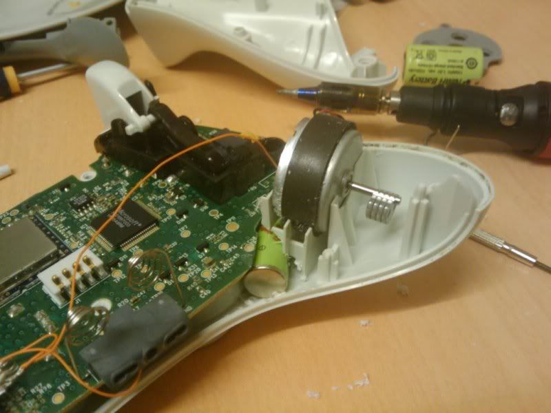

I've been working on getting it working while retaining both rumble packs, I'll post some pics up tomorrow. Looks  :cool:
Post Merge: August 19, 2010, 04:36:39 AM
Tried out some different battery options and I can fit AAAs in and retain the rumble packs.
Needed a bit of trimming but it fits.
I just need to work out how to make a USB charging circuit :? Any tips?

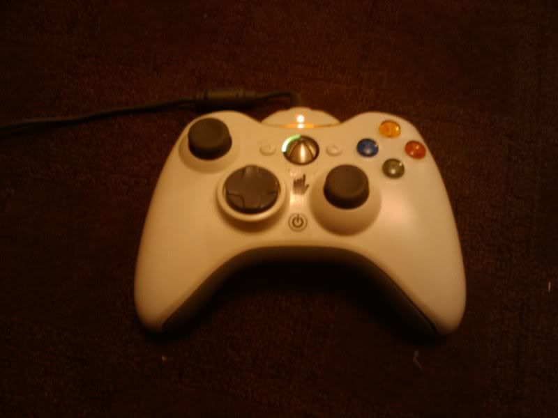

Latest update
Multi-coloured SMT 0603 LEDs and PS3 thumb grips
Having a bit of trouble with the USB charging method. I got a usb battery charger, removed the usb and battery contacts then soldered wires to a mini usb recepticle and to the batteries and nothing. The batteries charge separately and have separate LEDs for charging but I'm getting nothing. Any ideas?
Hmmm. Can't see anything wrong by the pic. And if it's charging then the wiring to the batteries should be right.
Umm. Have you tried giving the batteries a full charge before turning on controller? Or playing with the cable plugged in? When mine got low it'd wait til zero power then shut off suddenly, not like normal batteries. Maybe you're on low power.
I know it's not much to go by, soz. But I can't think of anything else. :dntknw:
