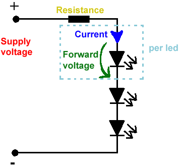

How many milliamps would be a good current for the leds to run in that circuit?(the diagram) That way I can choose a resistor.

So what your saying is something like this?
2nd Year EE

no you will want to make a parallel circuit, that is a series.

ok i made a parallel circuit and everything seems to be in order so thx to every1 who helped

k thanks i have to use a 12v source but thats ok =)  ... And a 29 ohm resistor.
