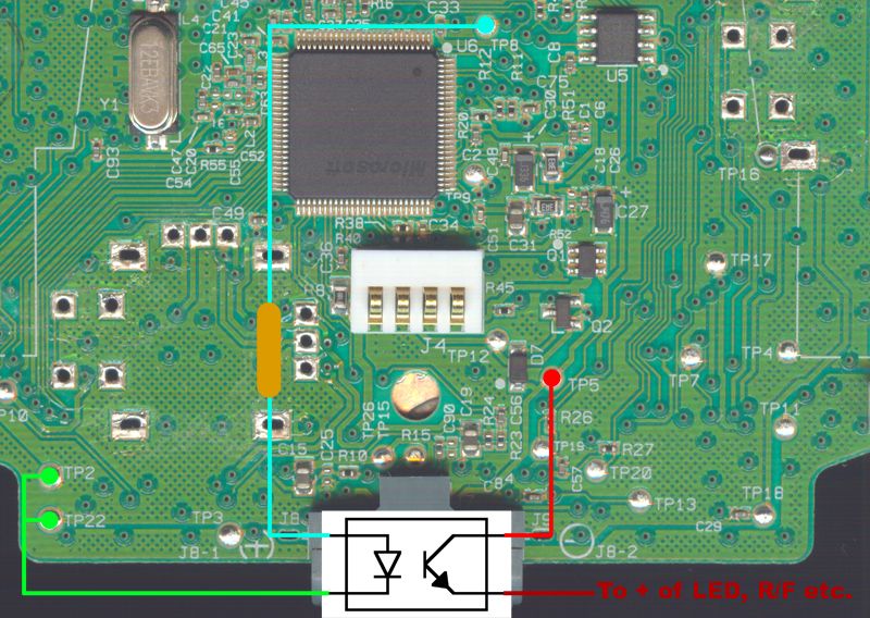

i looked at the diagram and its jibberish to me, i just need to know which points of the motherboard i need to solder to if i want my leds to light up then i can put them anywhere right?
What kind of motherboard is the controller? ... just match the motherboard to the picture and you have to solder your LEDs to that switched supply point.
but which one is the switched supply point? its a wireless cg2

The Wire that is this color is the switched supply point. You hook your 100 Ohm resistor to that point and then solder the positive side of the LED to the resistor. After that you solder the negative side of the LED to ground.
That Black triangle connected to the blue and green wire is a diode. A LED is a type of diode.
which point is ground and i dont understand the diagram at the bottom

the green line that connects to the points "TP22" and "TP2" are Ground.
TP8 is the Switched Supply Point. (the point the powers on with the controller)
Ignore the Red Part. That will have no part in your mod.
thank you so much i think i finally understand.

A Resistor isn't required if the LED voltage is higher than the source voltage, though in that case connecting the LED up to it is a moot point anyway as it's going to be under driven and not look as good or even work at all in some cases.
The switched voltages in those diagrams is 1.5v~1.6v depending on the version of controller you have, it's not going to power a 3v Rainbow LED.
Furthermore, powering them from a Wireless controller limits you to the maximum voltage of the batteries, which is around 3.2v for Alkaline and then around 2.8v for Rechargeable ones, and in the case of Rechargeable ones it will go up to 3.3v when the PnC cable is plugged in to recharge them. These battery voltages will also drop over time as the batteries are drained, down to around 2.3v, so it's not a regulated source for powering any LEDs and no Wireless controller has one high enough. They're not going to look the same all the time over this change in voltage.
Even if you go with an OC like those diagrams are laid out it's still never going to look as good as it could from a regulated 3v source, but it would be the best way to go about it as it gives you the highest voltage and keeps it switched without having to go to a Charge Pump or DC-DC converter.
« Last Edit: December 11, 2010, 05:43:25 PM by RDC »

IMHO your best option is to not put any LEDs in the thing at all, how often are you looking at it when playing a game anyhow?
You'd still need a Resistor since new AA batteries will have a voltage slightly over 3v, and if you ever switched to the PnC pack and plugged it up it's going to hit 3.3v, which is slightly over the 3v it's rated at, but in time could cause damage to the LED. The other side of that is the battery voltage is going to drain, so you not only have a slightly higher voltage that needs a Resistor to deal with it, but you have much lower voltages that you can't really do anything about. The controller will work down to 2.2v before the Low Battery indication will start to flash, but your LEDs will look like crud long before that and not.
If you use the PnC battery pack then the best thing to do is power it from the 5v of the PnC connector. This way it only lights up when the batteries are charging and plugged into the 360, and since you're using the 5v from the 360 as the power source so you'll have no problem powering your LEDs with the proper Resistor.
If you have to have it completely wireless and lit up then using the OptoCoupler in the previously mentioned thread is the best way to go about getting a switched source at it's highest voltage and not having to use a manual switch. In either case, OC or manual Switch, it's still not going to be a steady voltage because the batteries drain over time, and you're still limited to the max voltage that they can put out.
The only proper way to do it and stay wireless is to use a Charge Pump, DC-DC Converter or LED driver circuit to get a higher regulated voltage for the LEDs, but those are more complex than installing an OC or Switch.

You're not getting how this works at all. You can't use the AA power source alone, you need a Switch or an OC to make that a switched voltage. The Switched voltage in the controller is only 1.5v~1.6v, that's not high enough for an LED, but it is high enough to turn on an OC, which can then turn on the AA power source for your LEDs. Using the OC is the easiest and quickest way to get a switched power source from the controller, and they are beyond easy to find. The only thing easier to do is just use a switch, but then you have to turn it on and off manually.
Only the CG version has a switched voltage at the Headset connector, and it still changes voltage with the batteries, so you're looking at just about the same deal using it or an OC. Whoever started the rumor it's a regulated 3v on that controller was wrong, but it is a switched source that you could use for a couple of LEDs.

An OC is a Transistor that's Base is isolated from the rest of it, you'd also need 2 Resistors to use the Transistor as a switch and since the only switched sources in the controller are positive the Transistor can only turn the Ground on/off, unless you use 2 of them and then 4 Resistors. For an LED the Transistor method is fine to turn the Ground on/off, but for other things it's not, so again the OC is a better choice there as it's less parts and can turn on a positive or negative source depending on how it's wired up.
