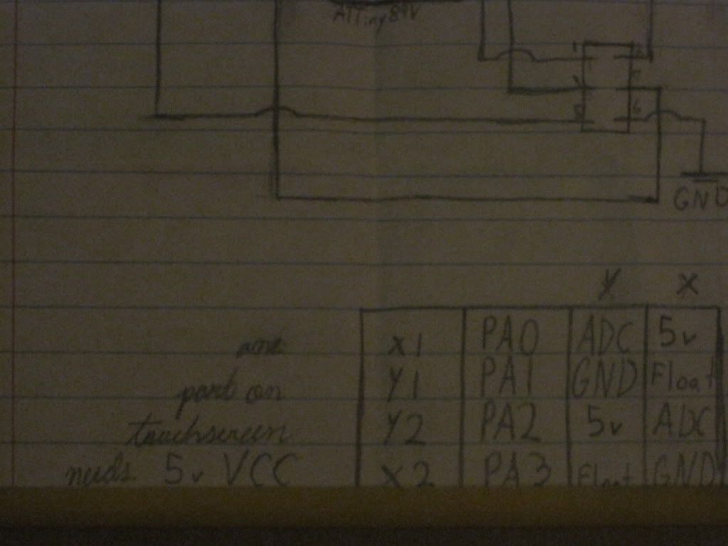

I know these schematics are ghetto ,but what the hell its the best I could do. I have no engineering software what so ever so let me know what you think.
Post Merge: January 21, 2011, 03:33:26 PM
Post Merge: January 21, 2011, 03:34:43 PM
Post Merge: January 21, 2011, 03:37:17 PM
the for wires that go to the right go to the touch screen as
going down
X2
Y2
Y1
X1

if you can clean it up a lil ill run it through cadd electrical. and post something more professional and easier to read. Dont get me wrong, awesome job. I got together a team of modders that are local to me, and a friend who is good w c++ . and we are ready for mass production. well kinda. its not like we have 200 lil Korean kids to do the work for us. The first of the month Im going to order all the hardware we need. I want to have a working prototype modded into a psp by the end of the month.

awsome man I will clean it up and post it up though with the camera I am using I will probably draw it on a poster. the picture is going to be huge! so I will try to down size it.

useing this schematic the voltage supplied to the touch screen in sent through the microcontroller.

If i can Ill try to get a single sided pcb designed from what you come up with. I have my own etching kit so creating a prototype pcb for this is not far away. If you can, plaese give me a list of everything needed hardware wise. from the schematic i can see a cap and some resistors and the attiny but what else? If you give me a list Ill find a good supplier.

3x2 ICSP conector
12k resistor
C 0.1uf
C 1uf TAG
and you can make the SIO plug from scratch saw it once. on the psp 2000 I still dont know the exact pin outs, but I asume its the same plus 6 for the video ports. although it could always be rearanged weird but check this page for phat pin outs. "http://mc.pp.se/psp/phones.xhtml"
Post Merge: January 21, 2011, 06:02:58 PM
all the rest of the circuit is inside the attiny84 and how its programmed.
programming ( very important)
« Last Edit: January 21, 2011, 06:02:58 PM by galaxy3arth »

« Reply #35 on: January 22, 2011, 03:39:38 AM »
As for 2k pinout: http://forums.ps2dev.org/viewtopic.php?p=65070#65070
are you sure u can solder that avr? (hot air soldering!).
MLF is 4x4mm in size
use PA5 and 6 for UART pls (can use hardware usi then)
dont use a 6pin connector for ISP but just some testpads (if u want to fit the whole thing into a psp)
u can probably make this single sided
I doubt u need the electrolytic capacitor if u use 5v from the psps hardware
reset pullup could become a problem for signle sided pcb
use assembler for programming, not C++ (can optimize more)
use external clock for stable uart (smd oscillator is almost as big as the avr but probably the smallest u can get)

Thanks Tokyo, the 2000 pin out looks great, thanks so much for that.
As for the soldering of the avr , I thought I seen a socket to accept the chip. I was thinking the chip could be flashed on the programmer and just popped into the socket?
Also Im thinking that we should include a usb adapter to add a usb device like a mouse or keyboard. So maybe if we use the design found here...
We then adapt usb to serial on our board. the back to usb for extra peripheral? I dont know the power requirements for ATMega168 but the replacement the ATMega328 says 1.8V to 5V operating voltage. I think this is the rout to take instead of the attiny?

as for the schematic with the attiny84 I need help with the implementation of the UART I have never used one. :help:
« Last Edit: January 23, 2011, 08:41:07 AM by galaxy3arth »

DebugSio didn't seem to work for me on any FW other than 1.5
use tyranids sio lib from pspLink, it works for 3.xx (kernel prx though)
as for uart just use the hardware uart pins (usi is actually no uart but can be used as one)
maybe a voltage divider for avr tx

design prototype what do you guys think?
and yes that is a second analog nub.
Offline TokyoDrift

need a boost converter if u want to use psps 1.9V
probably use attiny84 low power then, 3.3V operation, if the touchscreen works with 3v3
didn't get a boost converter to work with psps sio though, cant draw too much current (at once? diode? no clue)
