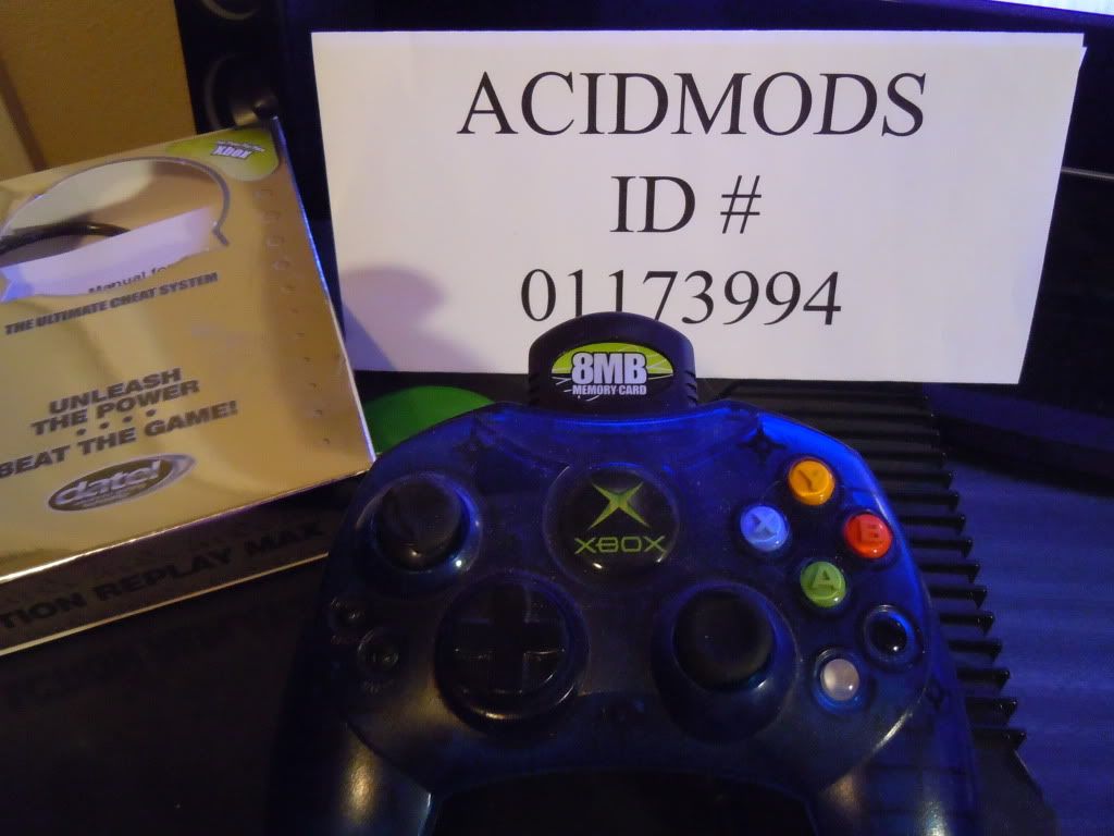

This is the xbox console that I will modd. Its been a while since she came out to play.
Front faceplate that said xbox is missing cause i used it on another project
Here are photos of my antec cobra 133 cable
Slim line DVD player I will use
The component cables and power cord
Here is a pic of a different console that i used the XBOX DVD tray front end piece on

First step I transfered the softmod files to the action replay, then loaded them to the xbox. I then boot the Splinter Cell NTSC first edition copy. Softmod done.
Next I inserted the Auto Installer Deluxe Disk into the XBOX and did a more through softmod install, I also trasfered the TSOP flash file X2 5035 bios in preperation for the TSOP flash.
Opened the xbox up and connected the proper pins to TSOP flash new bios. Reloaded the AID disk and completed the step.
I then swapped the stock hard drive out and inserted the 120g hdd. (did not have 150g hdd, it turned out to be 120g from a broken laptop)

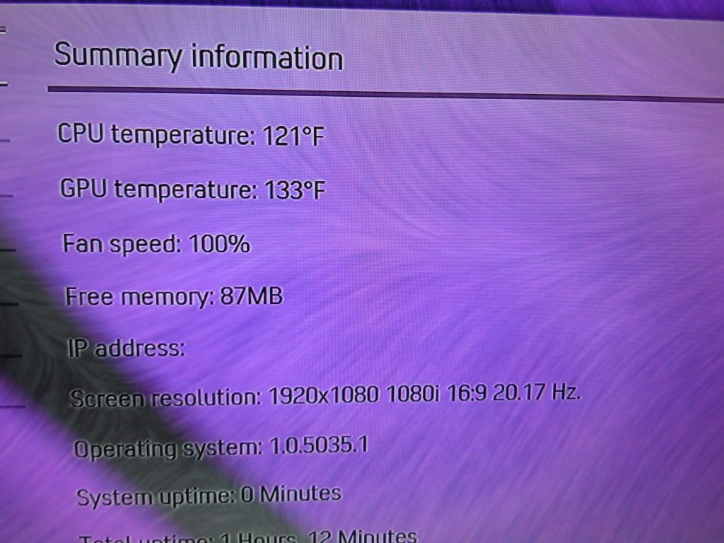

After this step then I loaded the XBMC installer disk, and loaded the full version of XBMC on the HDD.

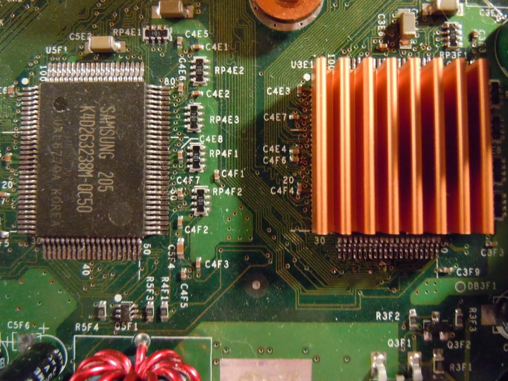

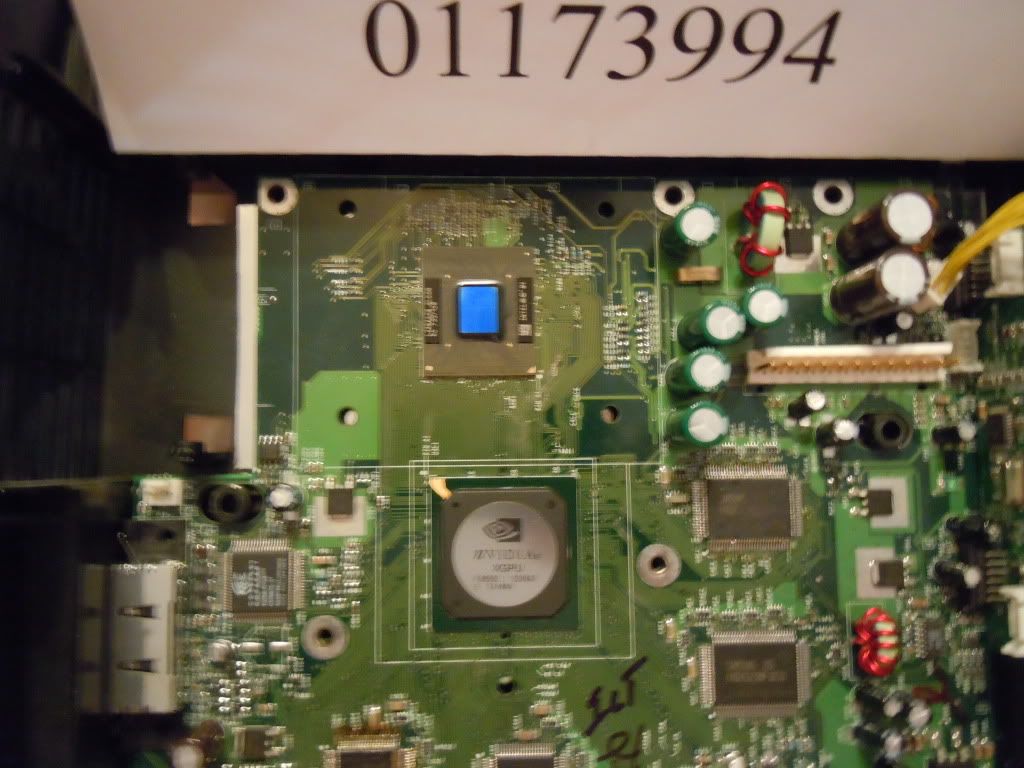

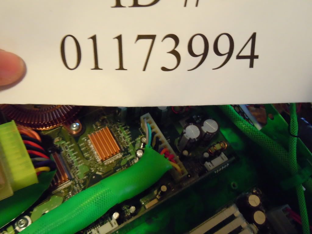

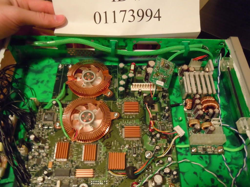

After this was complete, I then soldered the 4 extra ram chips to now have have a total of 128MB of ram. Also in the second photo the screen would usuall read 23 or so MB of free space, it now reads 80 somethin.
After all of this I test fit the iceberg fans. But I am waiting on thermal paste to finish the process.
This is what the heatsinks will look like on the ram chips. I will cut them to be more acurate in size.

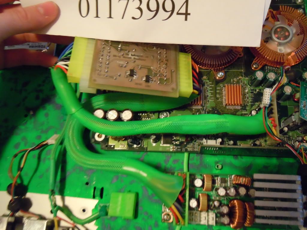

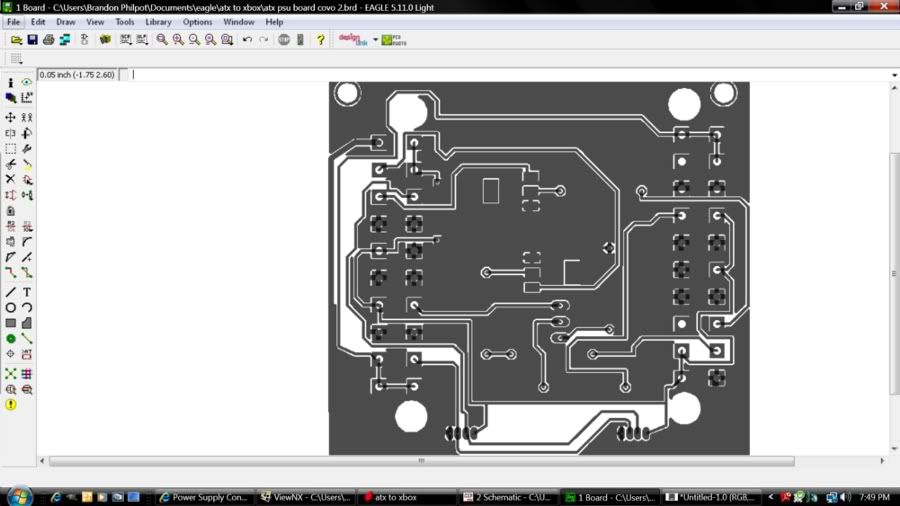

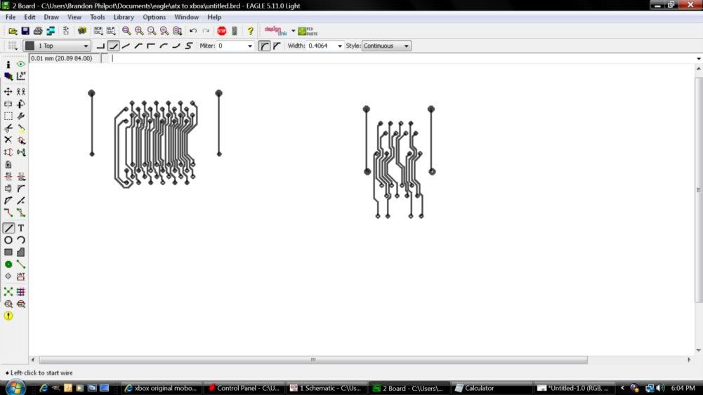

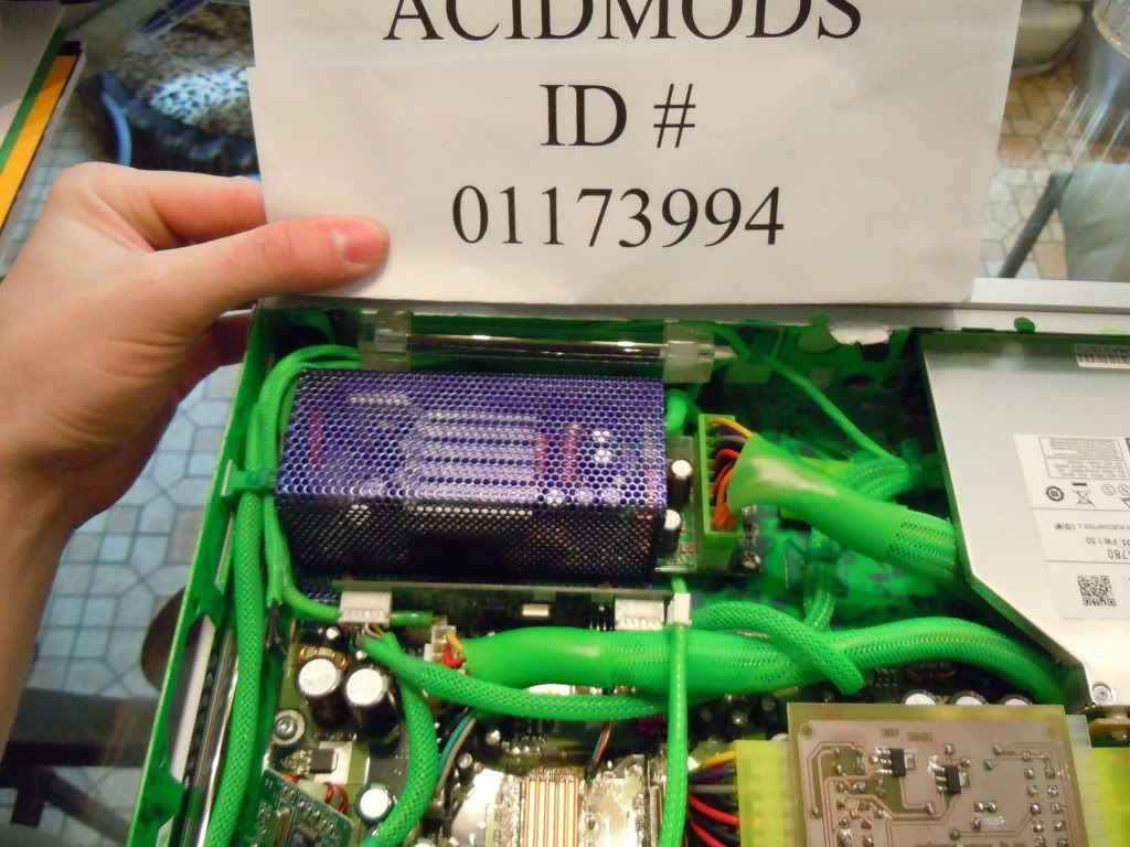

Ok I was up a good portion of last night and drew what my circuitboard will look like. It will have an atx 20 pin conector on both sides. The board will allow me to step down the appropriate voltages neccesarry for the XBOX to bott and stay on. I also in corporated holes to tie two 4pin molex connection for less clutter and a more asteticly apealing install. Less clutter and mess of wires = more eye catching install.
Testing one of the two SOT-223-3 Voltage regulaters for the circuitboard.
Going to either use a top mount atx connecter or the right angle mount atx connecter. Will use the right angle if space is limited.

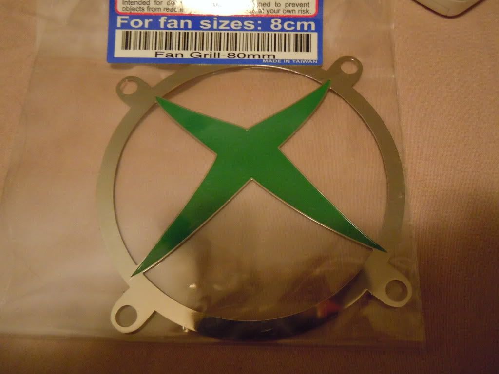

Pic of the custom 80mm fan grill I will mount on the top of the case.

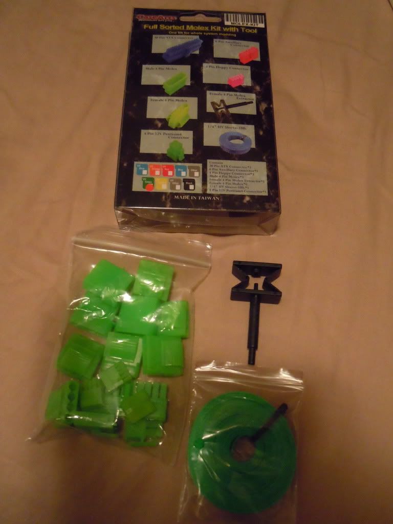

Various molex connectors that i will swap for stock white ones.

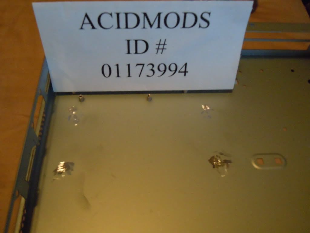

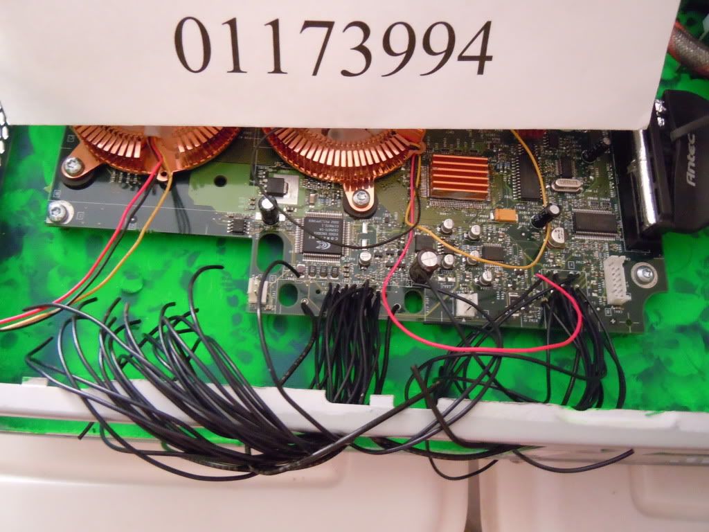

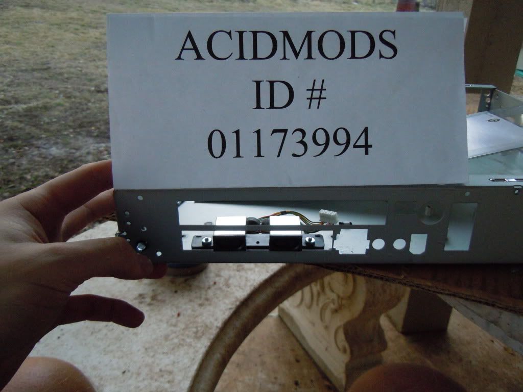

Today I have went ahead and tackled the metal connections for the connected ground plates under the XBOX mobo.
I first drew the sort of guide lines that I would want, so that way I could incorporate the metal risings that would be essential for the mod.
Before I could remove the metal casing on the inside I had to disconnect all of the connections, unplug the stock psu, and remove the controller ports.
I then removed the cage, and did a broad dremel cut of where the lines would be close to. After 4 or so times having metal shards in my eye, I now wear safety goggles.
After the main section is cut out i will go back and lay guide lines down with tape for more precise cuts that I will cut with metal nibbler tool.
Half of the way done.
Final finished end result after all cuts and filed down on the sides to remove any sharp points.

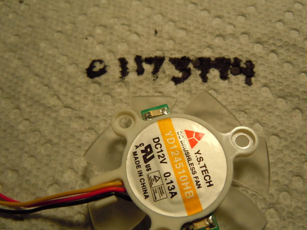

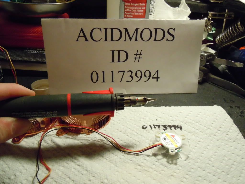

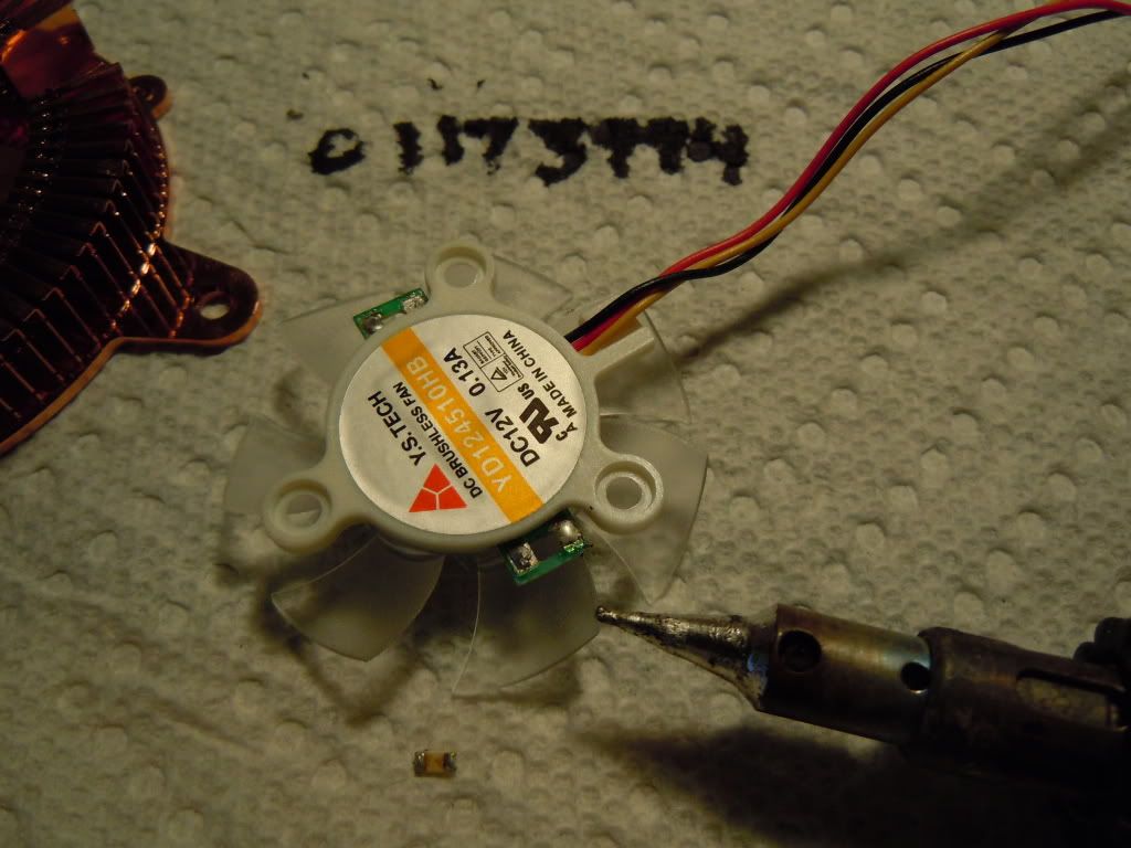

I also wanted to take the Blue Ultra Bright SMD LED's out of the fans, since they do not go with the colors that i will be having for the mod.
This is the Blue Point butane soldering iron I will use. I also use a ESD safe Hakko workstation sodering iron for more precision soldering.
LED before.
LED's removed.
« Last Edit: February 10, 2011, 03:27:16 PM by 01173994 »

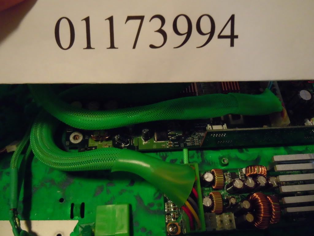

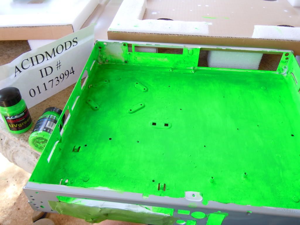

Some major wireing stuff came in today. Complete green UV kit, with molex connectors, zip ties, wire sleeveing, heat shrink, wire holders that clip on to sides of case and tons more things in kit.

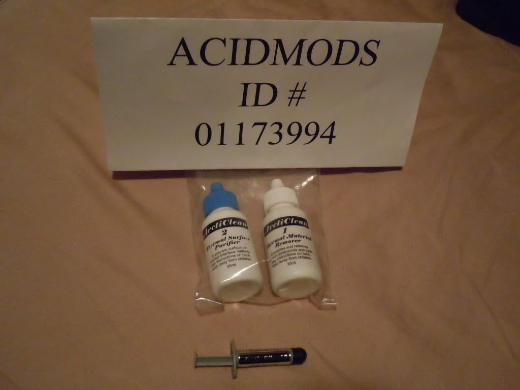

Thermal Paste remover, Thermal purifier, and arctic silver 5 thermal paste.

I cleaned the pinkish stock thermal paste off, then purified the area with the other solution.

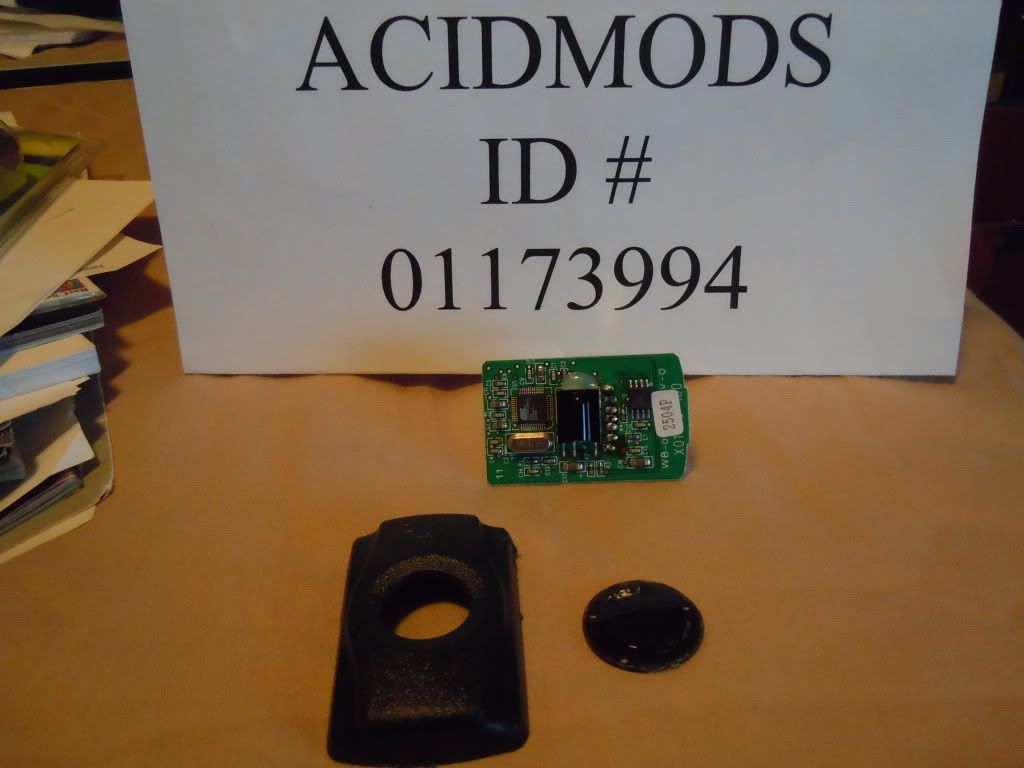

Took apart the DVD dongle to just have the PCB circuit and removed the smoked lens from the front. The lens will used on the front of the case.

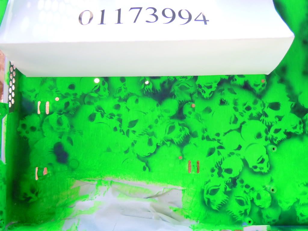

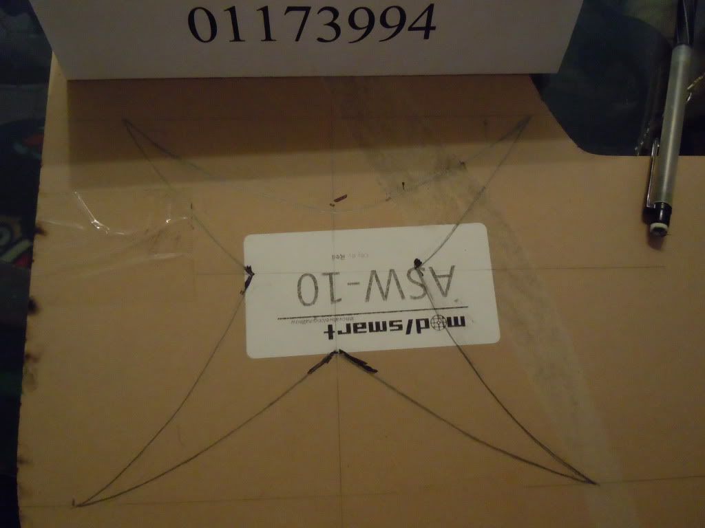

I drew a big drawing of the Xbox symbol, i will cut this out with a razor and the airbrush the X in, I will then go over that with a two part clear coat with the airbrush.

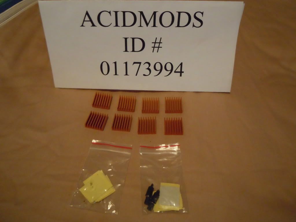

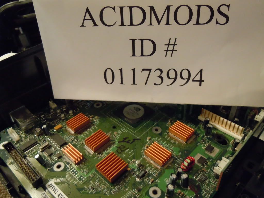

All of the heatsinks.
Cut the ones for ram chips and TSOP chip. I then cleaned all of them with alcohol to remove any metal flakes and dust.
This the end result attached to the mobo.

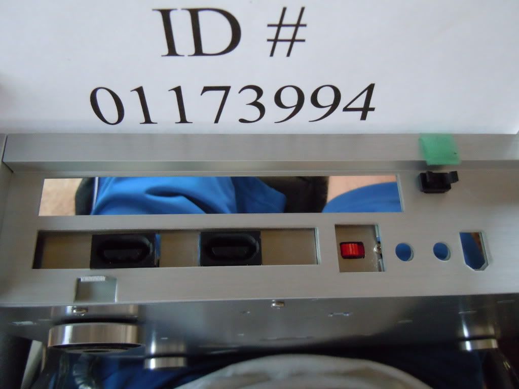

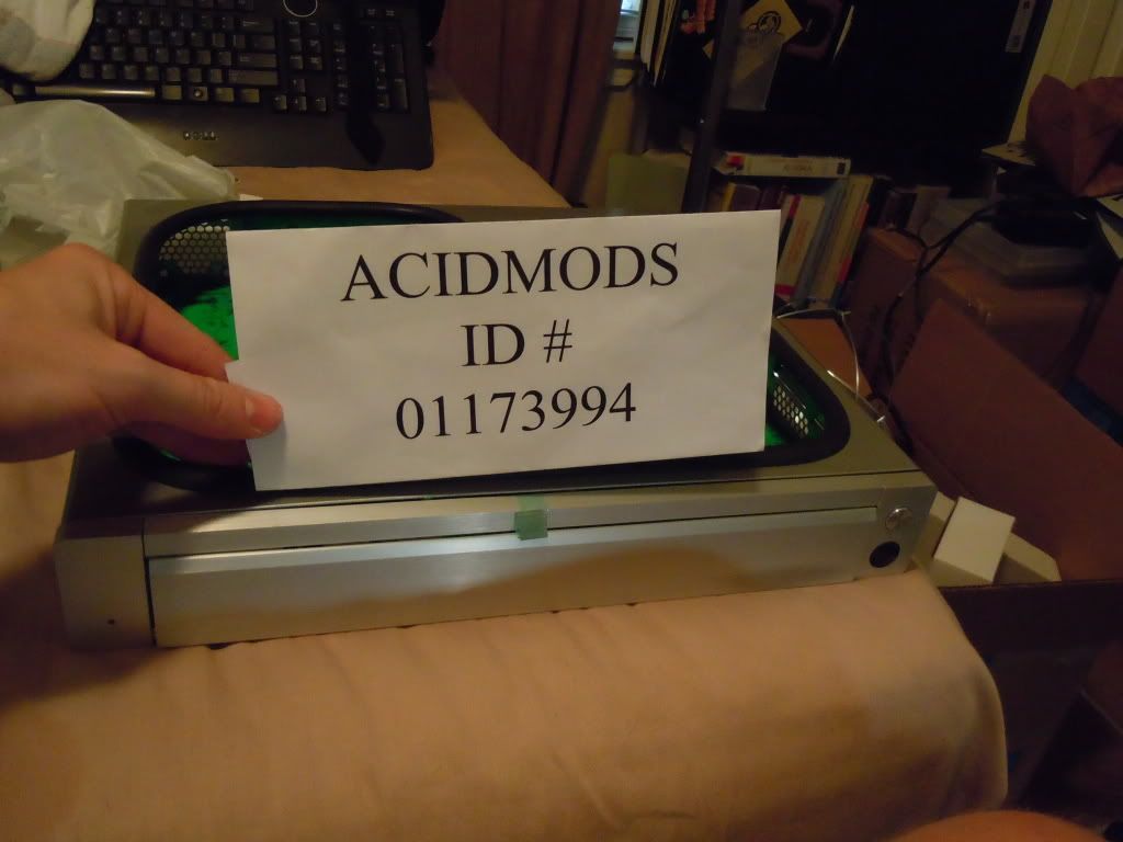

This is a big update to day not many pics though. First off got the case in the mail, along with the UV lights and clear acrylic rods to use as mobo standoff posts. The case is from silverstone, and it came with a whole bunch of extra connection, power source, psu, and what I believe is a 30mm fan. Second I opened the packaging I took it apart to work on it.
Case with how the top plexi and fan grill will sit on it.
Front of the case with flap opened. This is where I will put controller ports 1 and 2. I will also try to put some small mounted switches here also.

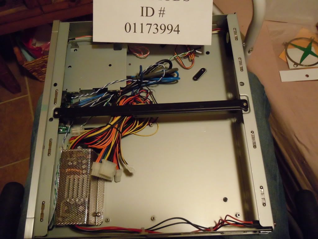

The inside of the case.
The UV lights will run across both of the sides.
Cut the whole in the top and mounted the fan grill. I also used some rubber fan whole sealer to make it look smooth.
Took off the entire front and drilled a hole where the led was at under the power switch and mounted the DVD dongle window.

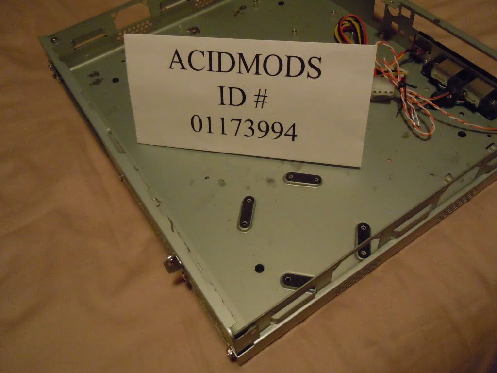

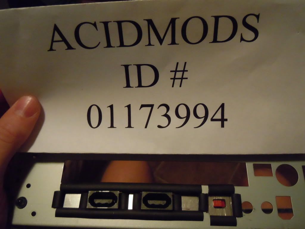

Ok couldn't do as much as I wished. I had to order some motherboard standoffs cause the acrylic rods were breaking on me.
DVD player fit to make shure it would work.

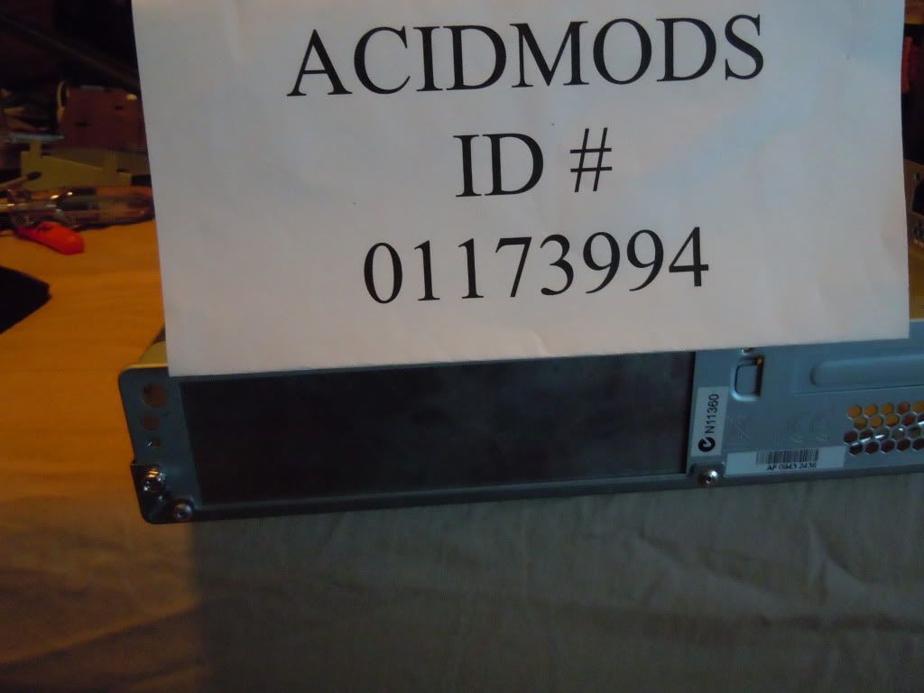

I then cut a piece of aluminum to cover the opening in the back, I will cut holes into the aluminum for the av out plug and ethernet plug. I will be taking the av and ethernet plug off the mobo and put them on a pcb because the whole is off centered from the Xbox mobo.
I dremeled off the original mobo standoff and sanded the area down flush.

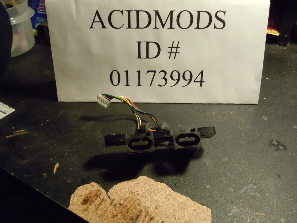

drilled holes and mounted controller ports 1 and two.
Then I cut another piece of aluminum to cover the gaps and in between the ports and the hole where the usb ports were at. I mounted a switch where the usb ports used to be.
picture what the cut piece and switch put in place.
This is with the trim piece added on top, I will look allot better when it is all screwed and glued in place.
So far everything is going great and on schedule.

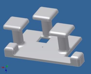

After I get the mobo standoffs I will start drawing the circutboard holders and the wire routing system. Also let me know if y'all would like to see more pics than what I am showing, I could do a few more in between shots.

Here is a pic of the lines drawn to have a straight cut, had to cut the front and back of the case.
This is what the final cuts look like.
This is side view showing that the top rest flush with each other. The back has a little gap but that will close when I screw the back shut.
I did get the mobo standoffs, but I still need to go to home depo to pick up some nuts to secure them to the case. As soon as the rest of the stuff comes in I will be able to draw the PCB holder stands and wire routing pieces. Then after that I will paint the inside white and paintover that with UV green paint. Then cut all wires to the perfect lengths, sleeve them, and route there paths. Airbrushing will completed as soon as the temp here in Texas warms up to proper temp for paint. I'm also still looking for a green see through logitec controller, I will mount the dongle for that inside, and attach a button and led. These will lead to the two hole in the front of the case.
I wanted to add this for the update instead of doing this on another post.
I drew the other PCB design for the AV out plug and RJ45 plug. I am having to remount these on a seperate circuit board. They plugs on the mobo do not line up where the whole in the back is.
And yes I love Xbox Media Center its great and allows you to watch video files that xbox usually cant display. I can also link it to a NAS server to stream my media and photos .

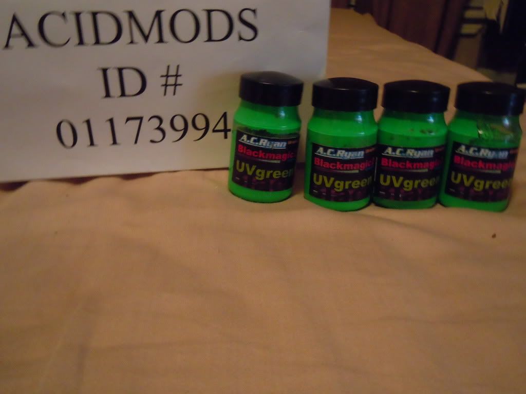

I also got my UV green paint in today.

I know its been a while since my last update. But was able to do some stuff today.
I was able to paint the inside of the case white, along with some other pieces that show.
After a few coats of UV green paint, I left it in clumps in some areas. You will see why when it all comes together.

« Reply #22 on: March 10, 2011, 05:01:29 PM »
Ok so I broke out the airbrush today.
Decided not to paint the box logo on the plexi.
Instead i decided to airbrush some skull stencils on the UV green.
Here is some picture from inside the case.
Here is shot of the DVD player holder and I also painted the metal covering that goes over the PSU.
These next few picture were shot in the dark with the UV lights on to show what it will look like. I was not able to put my ID in these do to no light.
Will be making the circuitboards soon so that way I can draw the circuitboard holders that will hold everything up.

« Reply #23 on: March 24, 2011, 10:31:27 PM »
Ok it has been a long while since I updated. For a couple of reasons and stuff going wrong. First aircompressor for airbrush blew up. It was only the second time I used it. Second still haven't received the controller in the mail. First set of circuitboards I messed up on so had to order new boards. Now on to the update.
I was able to make the circuitboard that will will change voltages necessary for the Xbox.
Changed the design a little to make it smaller.
Finished product ( it looks kinda messed up in some spots because some solder went flying all over it when I sneezed bah)
Front all put back together. Will put a logo on the right hand side of the door the comes down, if I am able to get hold of an air compressor in the next few days.
broke the plexiglass top got a new one in the mail will wait tell the end to put that in. but this is how it will look with everything put in.
Took the ports off of the back and soldered the wires that will leed to the other circuitboard I am making. (also had to modify the design for the board.
Mounted the heatsink fans and wired them up.
one of the 12" UV lights wire up.
Power wire loomed and also the DVD dongle wired up ready to mount.
4" UV light add to the mix in the front and all wired up.
4" UV light in the rear and the UV light power boards mounted. I also wired the fan that came with the case, and mounted it to the mobo as well.
Power wires running from the switch in the front to turn on and off both the 12" and 4" UV lights.
If I get the compressor I will also add the skull design to the mounts that I am having printed out. Hope I can finish this thing fast.

Did some more wiring work made both the loomed and wired harnesses for power to the circuitboard and from the board to the Xbox.
I also drew the stands that will hold the circuitboard. I used autodesk inventor.
This stand will hold the DVD dongle circuitboard.
Will also be drawing the stand that the circuitboard for the ports will go on, as well as the logitech controller dongle. Will update when that is finished.

Finished all the looming of wires for the controller ports in the front, have not done the logitech controller wires Do not have controller yet). Also wired the led for far left hand side, as well as the power switch. Cleaned up there paths and mounted holders. I also mounted the final 12" UV light.
Will put an led in the first hole from the left that will be tied to the logitech dongle led. The second hole from the left will have a push button to sync the controller. I used an extra power eject board from a previous Xbox project, cut it down to size. I will be cutting down an x buttun from a broken 360 controller paint it green, and then glue it to the push button. Will show some picks of that next update. after that all that is left is
