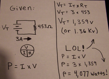

#4 GIVEN:
Resistance = 453 Ohms
Current = 3 Amps
Find my VOLTAGE.

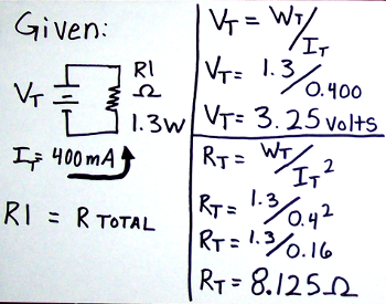

#6 GIVEN:
Power = 1.3 Watts
Current = 400mA (or 0.4 Amps)
Find my VOLTAGE.

4.] [spoiler]
(Voltage=) (Resistance=453 Ohms) (Current=3 Amps)[/spoiler]

6.] [spoiler]
(Voltage=) (Current=0.4 Amps) (Power=1.3 Watts)[/spoiler]

[spoiler]

Here are some practice problems to try. If you're stumped an any question just move on to the next and review using the worked out solutions at the bottom of the page.
Directions: use Ohm's Law to solve for the missing values.
Given: Voltage and Resistance

(Voltage=1.36kV)
(Resistance=453 Ω)
(Current=3 Amps)
Or your answer can be expressed as 1,360 volts
