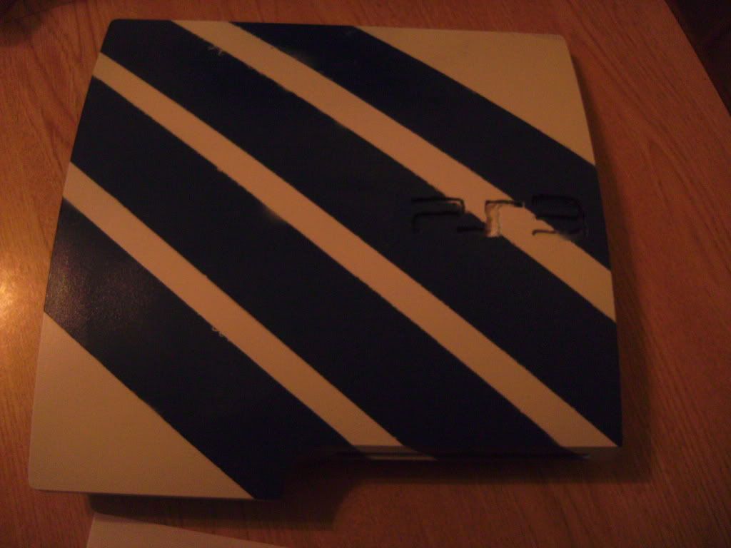

okay guys, i got the paint job done.  Their was some major scratches on the cover.  and even after sanding it down, the scratches still show the throught the paint.  The regular paint job looks nice, but the one corner looks like poop .  So i think i might cut out the corner and add a clear window for the heck of it.  and if anyone has any idea how i could get a stencil of some sort for the mw2 character ghost, that would be great.  I'll get pics up tonight

Maybe if you resand it and use some coats of primer you can make them scratches go away sand with some 320 grit between primer coats and you should see the scratches will fill in and go away then repaint it with the color you want or maybe even clear coat it a few times and sand between coats, might even help. just make sure you use something fine 600 grit to 1200 grit if you clear coat it

some pics with flash on and off.  I've decided to put in a small fan where you see the scratches and the corner i took a separate photo of.
^ note im still in the making of applying more coats of paint.  i thought i'd just make in epic bump for this thread.

I hate to sound like an   A HOLE but i think you should just repaint it black lol....

you need to restart.. and fix those logo letters, they are really jagged.

yeah man i didn't want to be the first to say anything so i waited till someone else did it for me but... Seriously dude the paint job looks like you didnt really put any effort into it. and i know sanding can be a pain but the end results are worth it!  :tup:
So yeah like Neo said you should restart. paint the case black again and sand, sand, sand that PS3 logo!

AGREED.
it started out really nice, and now looks like you just gave up and threw some paint on it... you could do better

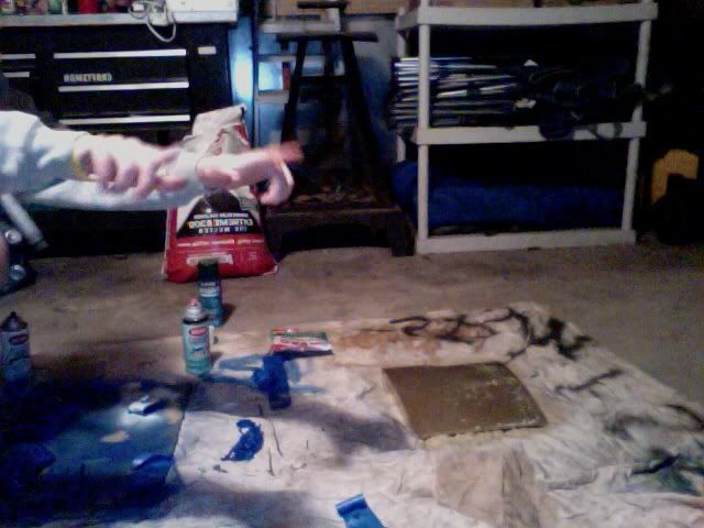

okay i restarted as you said and taking my time. did a completly different look and im putting white base with gold stripes. (((((IM TAKING MY TIME)))))) :hifive:
Here you can see the gold base color drying(clear coat)
next is time to put in the white
Thats my freind putting up the random sign.  He's painting an xbox 360 controller side by side with my ps3
« Last Edit: May 07, 2011, 08:53:42 PM by joeb0032 »
