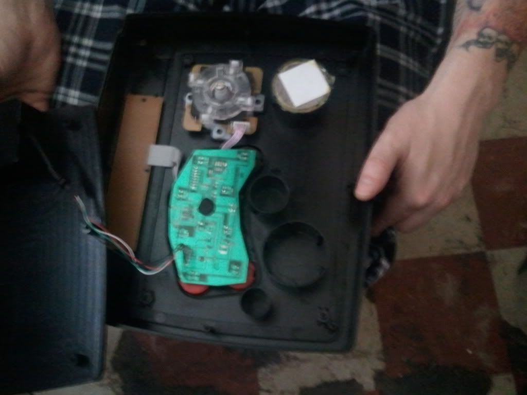

So far this is only my wireless arcade stick, No progress on the whole arcade until this works first.
This is what I got for now. Everything pictured I had or was given to me. (no cash build so far.) Still a couple buttons shy. Eventually this will be mounted in the other half of the ps2 case with a plexi top, with real arcade buttons.
I had to put this is when I found it. MK Dpad. SWEET! (might have to make a mold of this one)
The joystick out of the plug'n'play game was originally 4 way , I did some trimming to make it an 8 way. I'm not done trimming I am going to notch in an octagon pattern.
Before I made this harness up I wired things up to the ps3 controller last night, everything went perfect. So since this is still very early in dev, i made a clip to separate the ps3 controller from the rest of the mod.

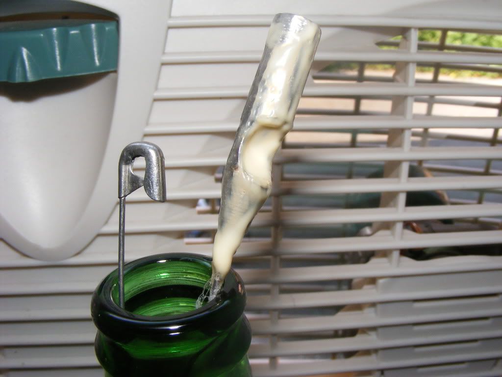

update on my arcade stick build...
mocking things up.. The buttons will be one off's clears of the big red button. I was going to use real arcade buttons but I'll save the money on this project by making my own. I also might try to recreate the dpad in clear oooh that would be sweet. The arcade will feature real arcade buttons. For now I am testing my analog joystick... I might replace with a real 8 way joystick. I have a blue skull somewhere. If not I have a scorpion image i can use for my skin instead.
MOLDING
MOLDING pulled.
MOLDS pulled..
So here is my MK dpad, if anyone is interested in me making this for the xbox , let me know. If there is no interest i will just save the mold.
« Last Edit: July 09, 2011, 04:28:06 PM by denali31004 »

So my friend and I found a working full arcade version of NBA Jams . The screen was shot but it still worked. So we began dismantling immediately. I have a larger monitor to replace the broken one. We will be removing all the NBA Jams stuff and selling it. The only things we are keeping are the buttons and the cabinet  . Inside will be a ps3 running all the emulators and some ps3 games. We are working on finding a usb powered 2.1 speaker system to run the audio through.
So here are some pics. Ill update with before breakdown once I get my friend to log on here and post them.

This is a usb adapter for systems with compatibility issues with fw or hardware idk. My 3.55cfw fat boy had no need for device. I had to read through the instructions to find out what it was for.
« Last Edit: September 26, 2011, 06:15:36 AM by 1TONpete »
