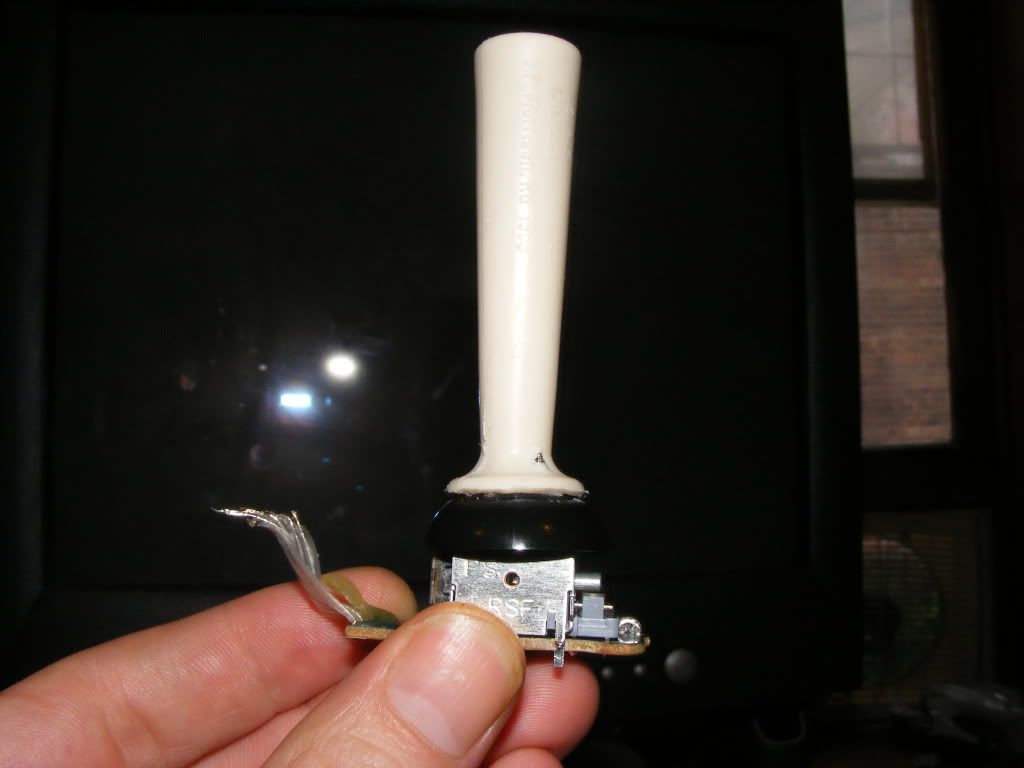

I want to do something like this but with buttons and at least one trigger. I think I might build on this idea. Take some lessons learned from the cyborg design, and try to create something more fitting. I'm thinking about molding my own pistol grip with buttons and 5 way switches. That will slide down over something similar to whats pictured below. BTW those of you questioning the build strength of this. The white stick is not plastic , its a door stop and is made from high density rubber. my 3 year old boy plays with this design regularly. It's on his controller. He is not gentle.
But granted these are not standard ps3 sticks, these are aftermarket . Usually means not as good build quality . One thing the improved on the ps3 the design was the tip that snaps into the thumb sticks is metal compared to plastic ps3 ones. The xbox controller i got in front of me has a plastic tip too. Also keep in mind the analog sticks in the picture are xbox style pots not ps3 4 wire halls. Which makes them more universal (cross platform)and cheaper and easier to work with , but exclude working on a real ps3 controller board. not that the mod couldn't be done to ps3 analogs. I just am doubting the plastic tips . I will test some as they are cheap to make. I will probably make a one piece molded analog joystick that can slid inside my grip.

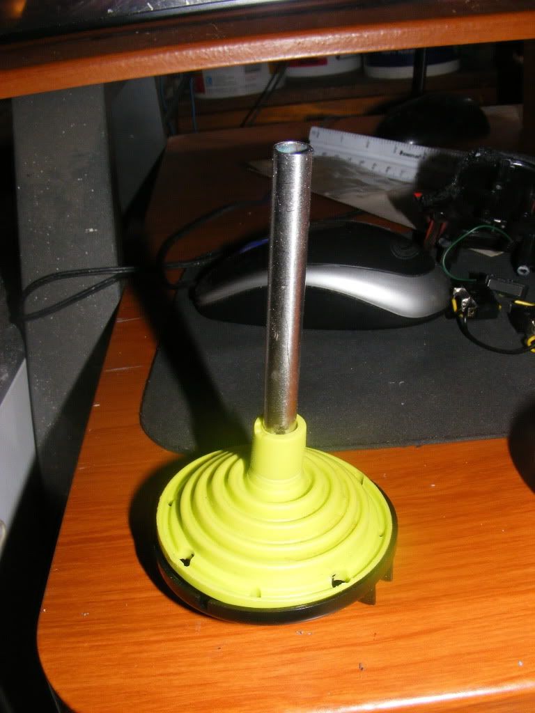

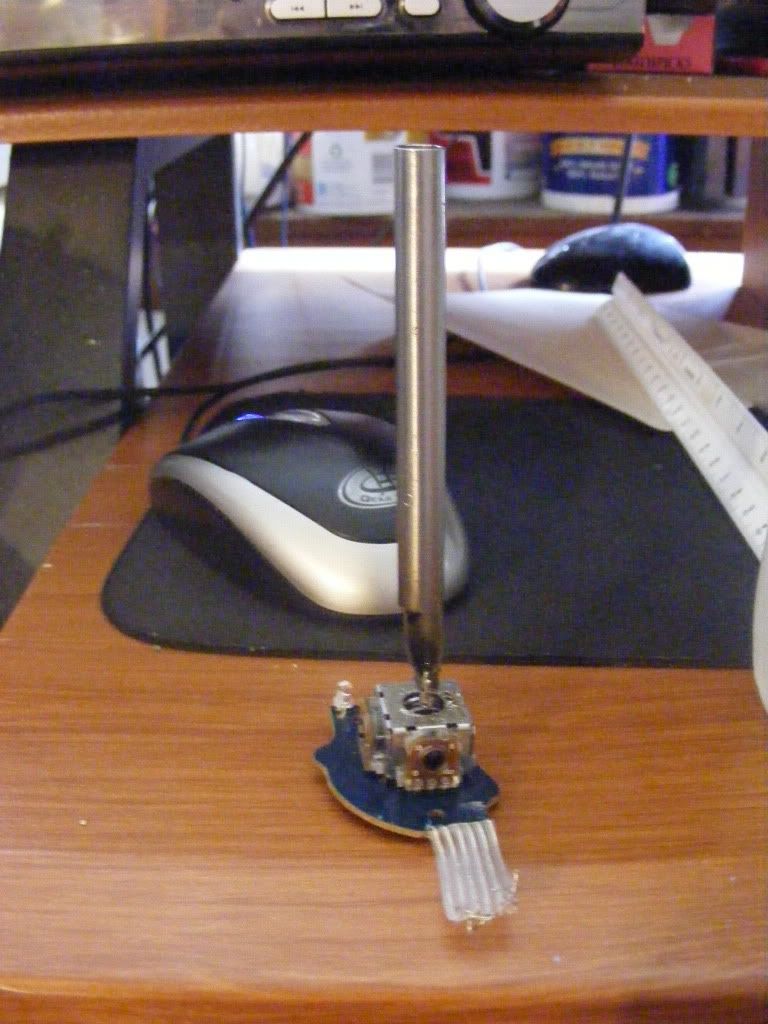

Here is my plan.

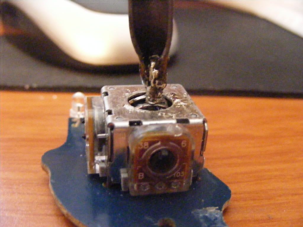

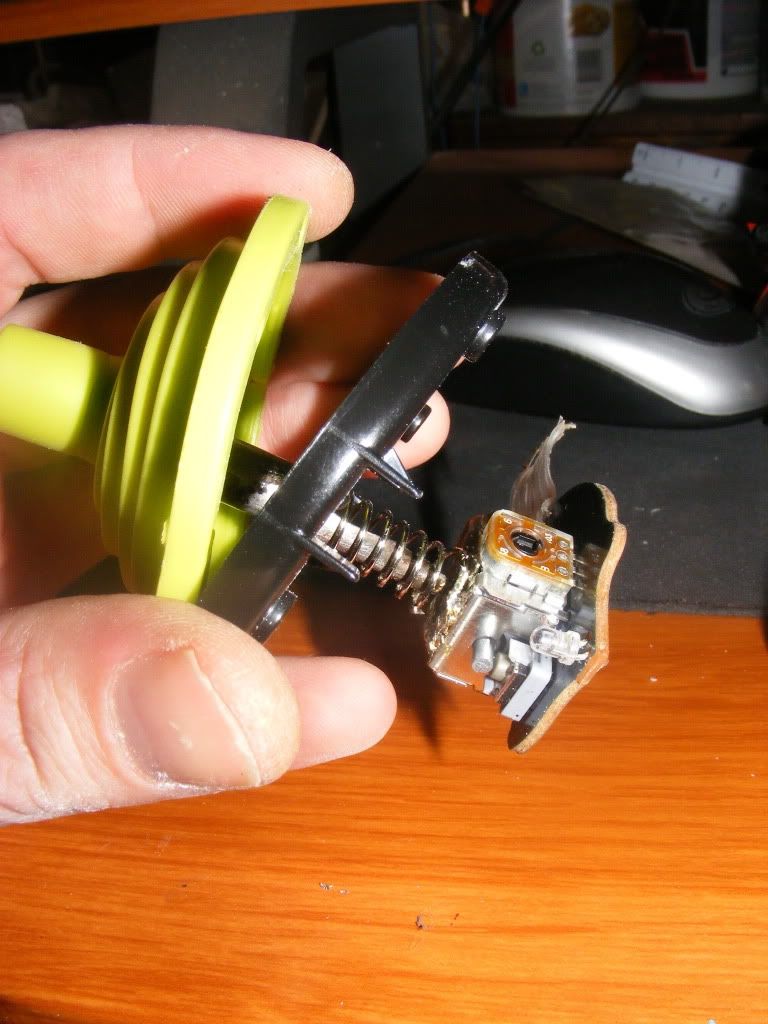

I will make 2 of these and mold grips with 5 way buttons and a trigger to go over the steel tube. The tubes are steel tattooing tubes. They are very strong and the action is smooth. I should have installed the spring first, but oh well. This mod will only work with certain analogs with a metal tip instead of plastic. I used a very strong solder not electrical.
