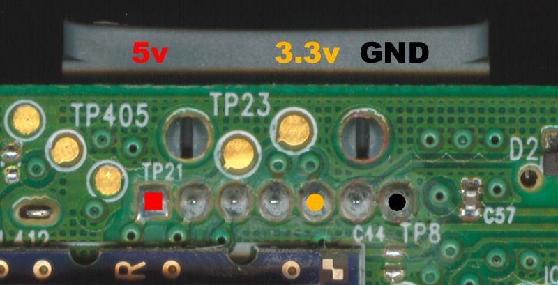

I was wondering if anyone has the pinout info for the plug and play wireless charge usb cable. I am looking to do a user programmable setup and would like to utilize the cable for communication purposes.

TP23 and the point next to it are the data lines.

So is this correct? Is there an in/out or either way does not matter? I notice 7 pins in the connector itself and only 5 points have been pointed out.

One of those points is data+ the other is data- . One extra point is extra ground , other I believe is for battery charge indication. Not 100% on the last part.

Which is which? lol
Within circle
Left pad=?
Right pad=?

dont remember... dmm should tell you.

Going off that pic, it's..
5v, D-, D+, Charge Status, 3.3v, Charge Status, Ground

hello,so i know how old this post is,but i really need to make my own cable here that goes out to usb.So i want to solder wires from each of the solder points on the board,and i know the pinout now,but i need to know what the charge sensor is ,is it positive or negative,or where on the usb wires do they go?Thanks,hopefully this sends you an email.  :cool:

The USB portion of the cable has nothing at all to do with the controller charging, it's straight thru. There is also no controller data communication over the USB aside from it telling the 360 that it can turn itself off after it's done charging.
If you're looking to duplicate what the PnC cables does, then in all seriousness just get one, they are less that $5 on eBay with free shipping and you'll spend far more than that in time making your own.
If you want to know how it works, then again get one and tear it apart and take the DMM to it. I've only torn down 2, an official PnC cable (incomplete schematic below) and then a Nyko one (much simpler inside) that I can't find the data for right now as it's pushing being a decade old and is who knows where, and I never bothered with completing any of it as they were cheap even back then and really not worth the effort.
