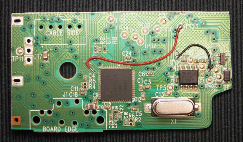

Hi RDC i've been looking for you on the net since i saw your 3PS60 mod the other day on the benheck forum which is closed for registration, i love the 360miniCL pcb i just wish i had one the skills and equipment to populate it.
iv started up this thread again because i can't pm you and and my mod http://www.xim3.com/community/index.php?topic=29881.0, ignore most of it as its mostly based off incorrect information that i have had the misfortune to find on the net lol, at the time of looking the infor up i had not all the donor parts to test.

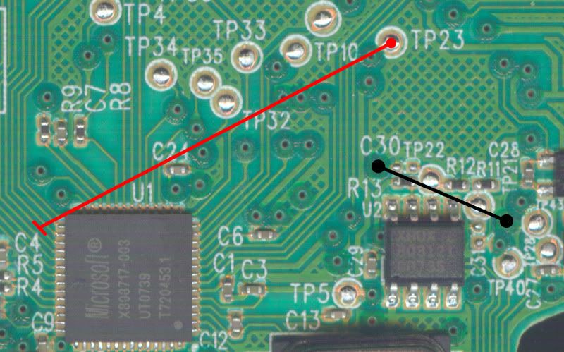

My mod is similar in to the 3PS60 in the fact i want to put a wired xbox 360 PCB in a smaller home and i need some advice from you on cutting one down, ie what equipment you prefer to use to cut PCB and where is safe to cut i can probably work that out but would like your insight and knowledge  i don't need such a small PCB as the one you cut down and id would like to use the headphone jack and have the option of using the too rumble motors. so can you advise me on how much i can cut away so that i can keep all that.
This is my PCB
the new type wired controller.
This is what iv come up with id need to find another place to connect LB and RB
any help will be much appreciated as i don't want to kill the controller PCB as i cant really just throw money at this project.
and sry for the use of slagcoin.com's pics.
« Last Edit: January 04, 2014, 01:43:38 PM by ManApe »
  • Posts: 2673
Re: 360miniCL Controller PCB
« Reply #14 on: January 04, 2014, 05:34:09 PM »
The most you can cut down the CL version board without making a huge mess is this..
Then it takes 2 wires to rebuild the board..
The only thing you lose cutting it that small is the Light Rumble Motor circuit, but that's just an NPN Transistor and Diode away from being rebuilt, or hacking off and using that part of the PCB.
The least you can cut it down is up to you and how much room you have to work with.
I use a Dremel and fiber reinforced discs for cutting a populated PCB, but most of the cutting type discs will do the job.
The Extreme 3D's POTs don't need changed from 100k to 10k, they're just voltage dividers. The 2 main issue you'll have there is Stick drift and slow down. Depending on how well that thing centers up when released, if it's off center too much the thing will want to slowly move, or drift, in whatever direction(s) it's off. Then the minimum/maximum voltages you'll get on them when moved to the extremes versus what the original stick did. If they're off much fro the original Stick then it will be 'slow' in that direction.
If you're wanting to make the Triggers Analog and Digital, then all you need to do is wire up the POT and then the button from the Trigger line to Ground. There's no need to get that technical with the exact voltages, and if you compared 2 or more controllers they would all be different anyway. If you want to stick a 360ohm Resistor on there that's fine, but it's not necessary at all, you can drive the Trigger line of the CL down to 0v an it will not hurt a thing.

Thanks so much for the quick reply you have helped a lot and confirmed what i already thought about the 100k pots being just used a voltage divider, i don't need it that small but that is very use full information to know, im hoping to keep as many TP spots as i can for less work on my part, also i don't really want to be trying to following traces and making new solder points much. as slagcoin.com have done the work for me.
The stick center well, only the twist can be off but thats if it not plugged in when flat but thats to do more with the original pcb calibrating it everytime its plugged in, like the sticks on the 360 controller its 50 degrees so they should match pretty well, the only one that doesn't is the throttle as that is 70 degrees and has a gearing to the gears may be 1 to 1 ratio tho so might not matter, i took it apart and wish i hadn't, as i may have broken the throttle at most and at least it will be hard to get it calibrated again, i may just replace it with a 10k 50 degree pot that i got before i realised i didn't need to change them, but that won't be easy either and it will have to be easily centered or it will be in pushing in one direction all the time. The best bet for me i think is replace the throttle with one of the thumb sticks either that or use both and have a switch to swap between them, or even get 2 identical resistors to center it and switch over to the throttle when i'm in the :censored:pit.
I want the finished product to look like it was always that way so dont like to mess with the outer part of the case to much, it would not look to good if i hacked a thumb stick onto it, others may do a better job at that than me. i have some 4 Pole 3 Position switches from an unfinished project that i may use to swap some buttons around for different game layouts, so with each Position i can swap 4 button around. they are easy to mount on the case as the hole won't show. i can also use one to swap from the centering resistors to the throttle.
Thanks again for all your help.
