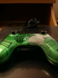

I've been hired to make a mini xbox 360 controller with the right analog stick even with the left stick, and the abxy buttons underneath the right stick for a handicapped gamer.
This is the controller I'm using. http://www.amazon.com/Xbox-360-Mini-Pro-Controller-Wired/dp/B005761CFO/ref=sr_1_3?ie=UTF8&qid=1349020333&sr=8-3&keywords=small+xbox+360+controller
Update: I cut the right analog stick and the abxy buttons out. I fiberglassed the hole from the analog stick. I filled the fiberglass with jb-weld and I sanded it down. I need to build it up a little more, so I put on some more just now and I'll sand that down when it is dry tomorrow.
Next I need to desolder the analog stick and rewire it and then I can put the analog stick hole in the case.

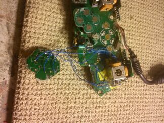

« Reply #7 on: October 16, 2012, 01:13:18 PM »
I see what you mean. If I have complication with that (witch I probably will), then I can trim those tall buttons down a bit probably. I'm using a wired controller so the circuit board is pretty simple so I might be able to just cut the circuit board where the buttons are going. There is only a transistor and a few caps where i would cut. It would be easy to trace back those compenents and re wire them if needed. It looks like those components are for the right rumble (which is not going to be present) so I may not even need those at all.

« Reply #8 on: October 18, 2012, 07:03:13 PM »
I got the analog stick hole in the case. The sticks are pretty even.

« Reply #9 on: October 29, 2012, 12:59:24 PM »
Sand, Sand, Sand, fill, Sand, Sand, and more Sand!

« Reply #10 on: November 08, 2012, 06:21:48 PM »
The case is ready for some green paint!
My theory was right. I cut the bottom corner of an extra controller i had and without any rewiring, the controller works. The components I cut off were just for the right rumble.

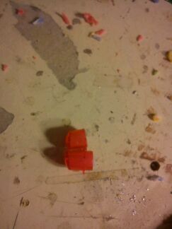

« Reply #12 on: November 23, 2012, 09:25:04 AM »
I had trouble with the height of the butons and even though I cut part of the controller motherboard off, it didnt fully resolve the issue but it helped though. So now, I cut half the height of the buttons and I dont have any issues now.
I cut the buttons pcb from the donor xbox controller I had and wired it up. There is only 1mm between the button pcb and the controller motherboard so it was a close one for sure!
I epoxied in the buttons pcb and assembled the controller after it dried. It's finished! I'm really proud at how this controller came together. You cant even notice I moved the buttons! This controller is flawless.
