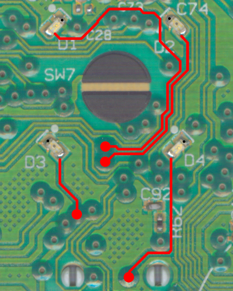

Hi i was wondering if anyone has a picture showing the led traces for a CG2 controller?
Re: CG2 LED Traces ?
« Reply #1 on: May 10, 2012, 03:11:44 AM »
wish i had a better pic of the traces, but this is what i made off RDC scans,  due to i had some CG2 Traces that were messed up , sorry for the delay been busy  hope this helps out...

the player one trace in the photo is not corrrect.
The via you show for player 2 isactually player one. player 2 is just below where you show it (under the player one led)
can someone updated the pic please?
« Last Edit: February 23, 2013, 10:05:38 AM by Modded Matt »

« Reply #9 on: February 23, 2013, 11:18:28 AM »
just a sec
thanks for rdc for the scans
here is one i just made
« Last Edit: February 23, 2013, 11:37:54 AM by snowcolt17 »

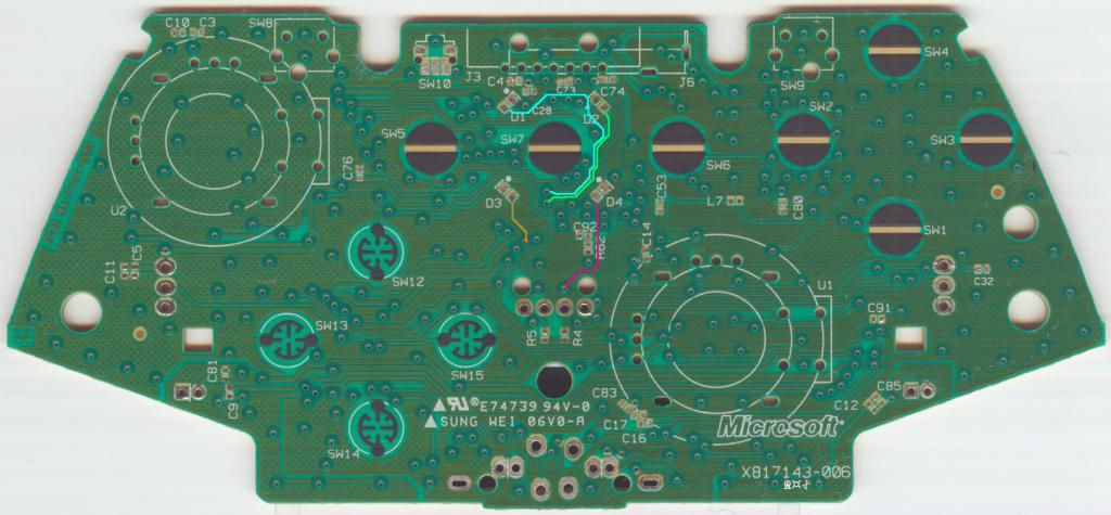

« Reply #10 on: February 23, 2013, 11:35:26 AM »
CG2 LED Traces
The other controller versions can be seen here - http://forums.xbox-scene.com/index.php?showtopic=512284
« Reply #12 on: February 23, 2013, 11:50:52 AM »
yep, much better.
