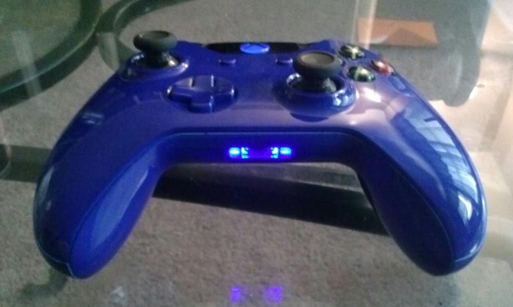

Ok so I completed my first LED lighting mod for the xbox one. There is not much different between the one and 360 controllers. (all LED mods for that matter) You need switched power and ground which MS has made it easy for us to tap into.
For my mod I used the LED chaser program by topbuz from the acidmods free code section. It was created for the 360, but over the years I have shown this code can be used for may applications. You can find the code I used here: https://www.acidmods.com/forum/index.php/topic,37478.0.html
Microsoft's new edition to the controller family has plenty of room to add chips and/or other components below the ABXY buttons, and the way the two boards go together, there is plenty of open space to run wire between the boards without worry of pinching them. As always, steer clear of the analog sticks to avoid pinching hazards. I run all my wires out the right side of the controller then after assembling the two boards, folded them over and made all my connections and mounted the chip below the abxy buttons and above the rumble motor.
For my main connections, I tapped into J5 and J6 connectors on the joystick board. J5 gave the sinc button signal @ pin 6 ane ground @ pin 14. J6 provided a switched 3.3V power at pin 4. See the pic below provided by RDC.
https://dl.dropboxusercontent.com/u/75177275/xbox%20one%20led/1537BBT_zpsc0fd1923.jpg
You can do the mod any way you want, but with the lack of new parts for the One controller, I could not buy clear buttons, but they are easily made buy using a dremel to remove all the black plastic from inside the button. The top of the button is clear, so once the blank is removed the led shines through.
Here is my finished project. Enjoy!
https://dl.dropboxusercontent.com/u/75177275/xbox%20one%20led/20131222_010437.jpg
Xbox One LED MOD
