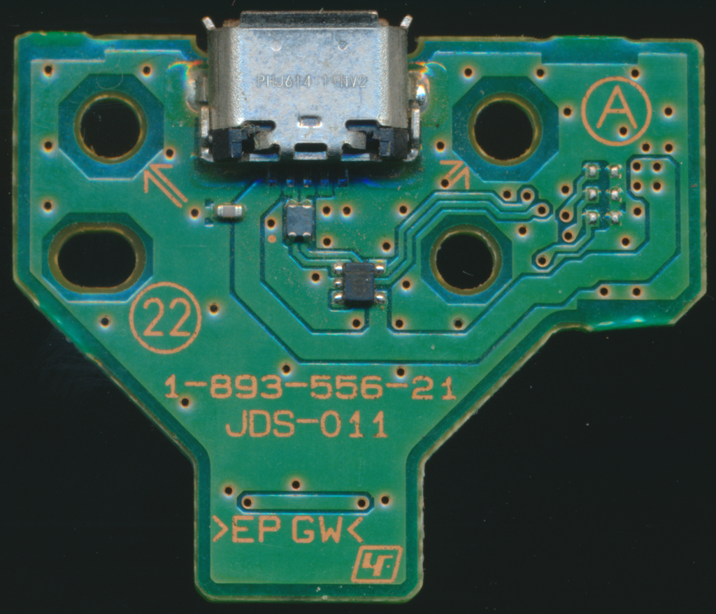

The JDS-011 board, aka USB/LED board.

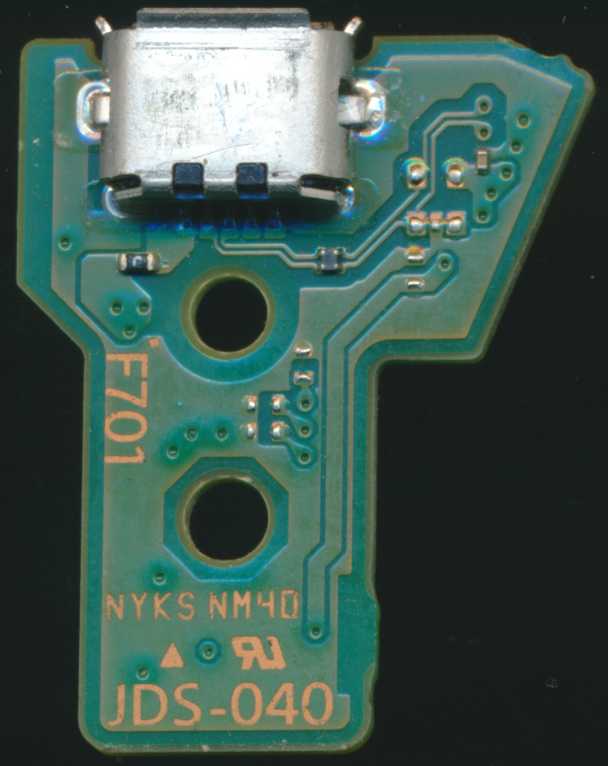

The JDS-040 board, aka USB/LED board.
