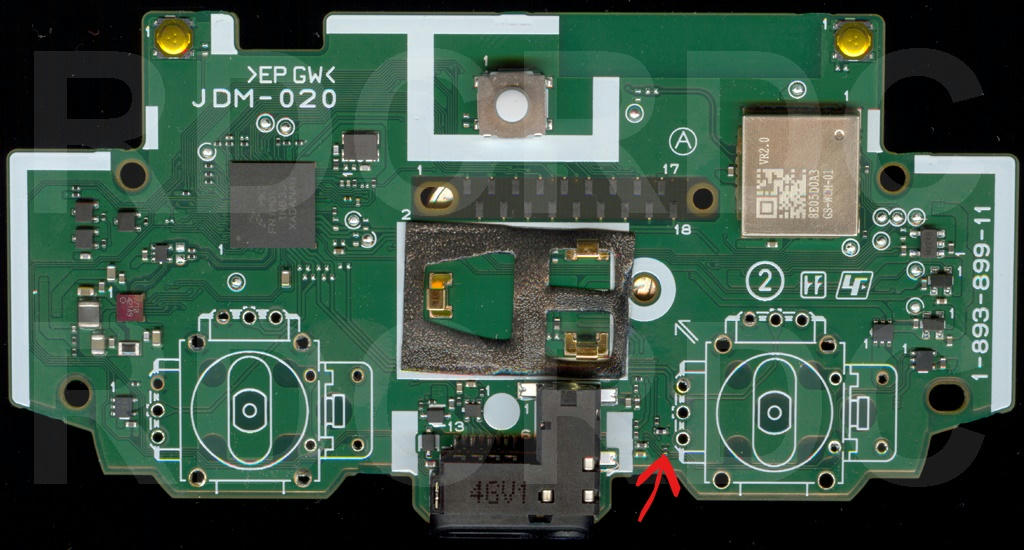

https://www.mediafire.com/?shpbv0s2cj1l3ah
Hello,
My ps4 says always that the battery of my controller is empty. i opened my controller and i saw the lowest resistor in the circle was missing. I thought it was a 100k 0402 resistor, so i placed a 100k resistor there. But when there is a 100k resistor my ps4 thinks that my battery is always full (3 stripes). I don't understand it, does anybody know which value is correct or does anybody know how i can solve my problem...
I hope someone can help me
Kind regards,
Eric
« Last Edit: February 16, 2017, 08:12:34 AM by kempie1234 »
  • Posts: 2670
Re: DualShock 4 Controller PCB scans
« Reply #87 on: February 16, 2017, 03:34:07 PM »
Hey Eric,
Both of those Resistors in that circle there are 0402, 150k, 1% tolerance or better. They make up a voltage divider for U1 to monitor the battery voltage, so they need to be the correct values.

« Reply #88 on: February 16, 2017, 11:42:27 PM »
Thnx for your answer!
I have ordered new resistors and i will let you know if it works. Only thing, there are 3 components in the circle, 2 resistors and 1 capacitor or? which one is the resistor and which one the other one.
Thnx!
  • Posts: 2670
« Reply #89 on: February 17, 2017, 02:06:55 AM »
I know there are 3 components there, but you only asked about the value of the one in the bottom of that circled group, and that's a 150k Resistor. The middle one is a Cap, the top one is the second Resistor that makes up the divider and the Cap is just a decoupler for the divider.
