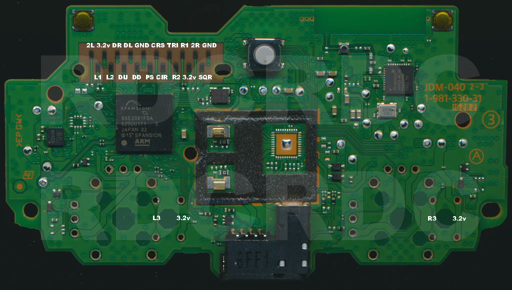

Hi guys,
Total newb here trying to put the guts of DS4 into my Madcatz TE2+ to make it wireless...  I read over all of the posts on this thread, but I am still confused.
My DS4 PCB is JDM-040.  I'm still confused about the wiring for L2 and R2 buttons.  So how does the wiring go in order to make those button functional?  My understanding is from 3.2v connect 10k resistor then wire that to L2 which then gets wired to one of the leads on the button, then 2L which gets wired to the other lead for the button for L2?
so from DS4 PCB, lead for 3.2v --> wire --> 10K resistor --> wire --> L2 on PCB  --> wire --> L2 button lead, and then other L2 button lead --> wire --> 2L on PCB.  Is this correct?
Any help will be so much appreciated.
  • Posts: 2670
Re: DualShock 4 Controller PCB scans
« Reply #95 on: May 12, 2017, 12:34:59 AM »
Depends what you're definition of functional is. Those buttons are Analog, but if all you want is for them to be is Digital (on/off) like an arcade stick button, then just wire them up how you're thinking they go there, as that is correct.
3.2v--(10k)--L2
L2---New L2 button (one side)
2L---New L2 button (other side)
Then just repeat the same thing with another 10k and R2/2R for the new R2 button.
Also remember that L1, R1, L3 and R3 all use 3.2v as the Common. All other buttons use Ground for the Common.

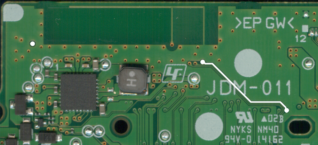

Hello everybody,
My problem is that my "options" button is not working.
When i opened the controller i could see a white thing around the button on the electronic plate, like "powder".
I cleaned it up, but i cannot see what is wrong.
Can someone tell me what happened here?
It is the JDM-011 version.
Sorry for my english, i am from germany.
« Last Edit: July 06, 2017, 09:48:47 AM by Zero-X »
  • Posts: 2670
« Reply #100 on: July 06, 2017, 05:58:45 PM »
That powder was probably just left over from the board when it was cleaned and does not hurt anything, unless you spilled something on it?
Does the button still click when it it pressed? If not, then it is probably bad. They can wear out or fail early and still click though. That is the first and easiest place to start, either replace it or use a DMM and see if it is working correctly.
Offline Zero-X
« Reply #101 on: July 07, 2017, 12:48:01 AM »
Thank you for your answer.
Yes, the button does click when pressed.
I yoused a dmm, between this two points, and pressed the button and it still works.
It seems that the button himself is working, but the signal is anywhere interrupted.
Thank you in Advance.
  • Posts: 2670
« Reply #102 on: July 07, 2017, 01:10:23 AM »
You can trace it out and see if there is a break, but then it goes right under MCU where you can not really check that connection. If the trace is good, then either the BGA solder joint at the MCU is bad or the MCU is bad.
Offline Zero-X
« Reply #103 on: July 07, 2017, 01:38:10 AM »
Thank you, i will check it later.
1.Is the white marked line that trace i have to check?
2.Do you know if there is a resistor or anything else between the button and MCU?
« Last Edit: July 07, 2017, 01:48:13 AM by Zero-X »
  • Posts: 2670
« Reply #104 on: July 07, 2017, 01:44:16 AM »
Yes

I'm a noob at this but want to attach a ESP32 to my JDM-040. The goal is to use GPIO pin from the ESP32 to control L2/R2 trigger, for best I want to use PWM (the ESP32 supports PWM@5MHz, so it will be just fine with a small capacitor). But I'm confused about how the triggers work.
So far, I got that
3.2v-----10K Ohm----L2 pin----a Variable resistor that gets low resist when press the trigger (I guess) ----2L pin.
I have detached the original bottom flex and used a led to test some voltage on those pins.
I could read a relative high voltage on 2L and R2 pins (in RDC's pic, reply #95) refer to GND. (So, I have a different JDM-040 sub series or the pic was miss labeled.) I couldn’t tell whether the brightness was between 2L--LED--GND and 3.2v--LED--GND. But I still can get a quiet low brightness when doing 3.2v--(+)LED(-)--2L and 3.2v--(+)LED(-)--R2.
Aside from this, I got an ultra-low lumen when comparing action/DPAD button with GND, but it was darker than everything, I guess there is a quite large pull up resistor there.
As I don’t have something that can easily determine voltage or resistance, I have difficulty understanding how them work.
I have found that L2 pin seems doesn’t have any currents when connected to 3.2v or GND. And when the button flex was removed and no 10k resistors, I could see a little value on both analog triggers and noise when I move the joystick. I tried to use a resistor to connect L2 to 3.3v, the trigger seems to be fully released and when L2 is connected to 2L or GND, the trigger shows being fully pressed. These seems like that the L2 pin is connected to an ADC and 3.2v-L2-2L is a voltage divider, but why not 2L=GND, or it isn't a voltage divider?
Is there any way that I can just use voltage to control the two analog triggers?
Sorry for my bad english.

Hi all, i started to working on my home project, and i have some questions.
1. Why i can`t use solder points marked with green rectangle?
I`ve read that pad buttons will stop working, ok, but if i desolder those points will it back to normal?
2. If i don`t desolder analog sticks do i need to solder 10k resistor between pin 3/4 and 17/18?
3. Is 3.3V safe for pins.
Thank You for help!
  • Posts: 2670
« Reply #118 on: January 04, 2018, 05:36:47 AM »
1 - Who said you can't use them?
It all depends on what you are using the controller board for. If you plan to keep the controller complete, then no you can't use them as it will ruin the connection to the daughter board, that thing plastic flex wiht the button contacts.
If you are making an arcade stick or some other project were only the controller board is needed, then yes you can use those spots for button connections after you scrape away the black carbon coating on them and expose the copper under there.
2 - The sticks have nothing to do with needing the 10k Resistors there, they are to take the place of the ones that are on the daughter board when it is removed. If you remove the sticks, then you need to put Resistors in place of the Sticks, so the controller 'thinks' they are still on there and in the center position. The Resistors between 3/4 and 17/18 are needed because the daughter board is missing.
3 - The PS4 controller uses 3.2v for it's main power supply voltage, so it could interface with a 3.3v system.
