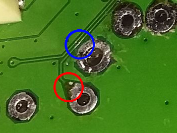

« Reply #182 on: August 02, 2019, 08:09:31 PM »
Greetings Fellas!
This is my first post about a problem with my ps4 dualshock controller, PCB board model: JDM-030.
I changed the whole right joystick because i was having problems with it. So after i finished and was testing it, i noticed
that the R3 button was not working. So after visually inspecting the PCB board, i noticed that i'm missing probably a resistor
that got loose when i applied heat to unweld and weld the new right joystick.
Do you guys think this might solve the problem ? and what is the value of this resistor ?
Thanks and regards

  • Posts: 2670
Re: DualShock 4 Controller PCB scans
« Reply #183 on: August 02, 2019, 08:27:43 PM »
That component is just a decoupling Capacitor, it's not going to kill R3.
The component that could disable R3 is just below and to the right of the spot you marked, and from that image it looks intact. I'd have to guess you tore some of the plating or trace around the R3 when removing the old stick. Remove the stick and follow the trace from the aforementioned component back, or post some pics of the board with the stick removed.

  • Posts: 2670
« Reply #186 on: August 03, 2019, 02:03:57 PM »
That Resistor is just down and to the right of the spot you marked. It's still intact.
I can't tell if that trace is messed up for the R3 or not, because BotoPhucket has it's logo feces all over that spot, had to save the images and rename them to get a decent look at them, that site is just worthless now.
I see 2 spots things that are questionable.
Red circle - The trace right at R3, can't tell if that's just flux or if the trace has been damaged/removed there.
Blue circle - If the R3 trace there was scratched and the copper exposed enough to make solder stick to it, like how it looks in the pic, and if when you had solder on the ground lug there next to it if that bridged then it would have kept R3 from working.
Offline McClane
  • Posts: 5
« Reply #187 on: August 03, 2019, 02:34:01 PM »
I think that's flux, because the trace is not open when i measure continuity from the R3 contact on the red circle to the exposed trace on the blue circle that you made.
But i guess that's a possibility that the exposed trace made contact with the ground lug on the blue circle.
I'll solder a new stick again and take into account your 2 observations and see if that does the trick.
I'll let you know.
Thanks.
Offline McClane
  • Posts: 5
« Reply #188 on: August 04, 2019, 09:11:54 AM »
Greetings RDC you were spot on.
Thank you very much!
My R3 is working, the problem was on your observation on the blue circle.

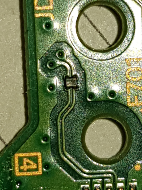

Offline Romario
  • Posts: 5
« Reply #191 on: September 01, 2019, 04:38:30 PM »
Boa noite.
Sobre a pcb do ds4 ( jdm 030 ), gostaria de saber  pouco sobre a linha onde entra a carga da bateria pois após uma limpeza 3 componentes foram retirados acidentalmente e agora não sei o que são e para que servem.
No caso, seriamas 3 componentes que ficam juntos e bem próximo a entrada da bateria...
Caso alguém saiba quais são essas peças e para que servem, por favor me ajudem com esse problema.
Agora a pcb não liga mas.
« Last Edit: September 01, 2019, 09:59:55 PM by RDC »

Offline Romario
  • Posts: 5
« Reply #193 on: September 02, 2019, 05:10:52 AM »
No caso seria esses três componentes que estão faltando na placa... Não sei o que são e nem para que servem.
Desde já agradeço a atenção.
  • Posts: 2670
« Reply #194 on: September 02, 2019, 07:12:51 AM »
They make up a voltage divider, most likely for the MCU to read the battery voltage or some other feedback for something.
Left to Right.
150k, 150k, 1pf
All are 0201 sized. The Resistors are precision, they should be 0.1%.
« Last Edit: September 02, 2019, 08:06:39 AM by RDC »

The fact some buttons work and others don't is a little odd. Was anything spilled on the controller? What is the Resistance across the Share button? It should be a couple of Mohms or so.
Offline C44Supra
  • Posts: 9
« Reply #209 on: December 16, 2019, 01:40:00 PM »
Nothing spilled on it no, I take good care of my stuff. Resistance across the switch is roughly 8.2M Ω
