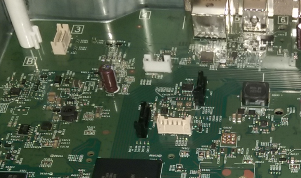

do you have some pics of the xbox one taken apart ? i searched the internet and couldn't find anything

easiest way would be to get to the bottom of the motherboard to  get to the hdmi points where you can not mess them up cause you will need to solder them
I really appreciate the pics you have shown me also could you take a pic of the dvd drive plug also ?   I haven't had the time to mess with one of these but i am thinking that a led storm might plug in the same way on these as they did the xbox 360 console :)
i believe the dvd drive plug is the same shown here in this pic  but i want to make sure :)

Yes it looks similar to a 360 and I already verified  the 12v source and ground locations on the connector and spliced for power I've never used a led storm kit how does it work if u don't mind me asking because I already have tip31s and tons of strip leds
In that pic top left connector goes to broadband card the others are for the bluray and hard disk drives.
I see cables that go from Hdmi to rca so I'm sure I can find the audio signal on the hdmi Jack but Will the digital signal drive the leds with a tip31? I hate to mess anything up.
I have an old 360 I might play around with to see if we can get a tip31 to run off a digital signal from an hdmi port without risking my Xbox one
I'm not ok with a Mic on the storm led sitting in a case being unresponsive also was gonna do a 3 position switch so I can power them with and without the tip31 and also cut them off

Led storm plugs right in the dvd drive and is the easiest way possible to add leds to an xbox 360 consoles also i am thinking it will work on the xbox one there isnt much information out there about these xbox one consoles yet that is why its nice to see someone trying to modify one
2nd question
being the xbox one is new that is why i haven't been able to look at one i have some in stock just with me buidling jtags and rghs all the time so this is why i asked about seeing pics of the bottom of the board to try and help you figure that out for the leds
3rd its been along time since i use tip31 i do have a tutorial on a xbox 360 that i used them on with all the av and hdmi ports showing which points to bridge etc for the hdmi that is why i asked for a pic of the bottom of the xbox one motherboared to try to help you figure out what you need to add the sound actived leds to

Sorry I was kinda writing as it came to me I will get pics I didn't kno anyone had done a sound reactive mod via hdmi or spdif previously I did see u had done it via av again my bad it's prob not gonna be today tho maybe 2morrow I can get pics from the bottom of the board and thanks again for all your help and advice

No problem once i see how the HDMI port is layed out i might be able to help you get this going a little further along.    and thank you again for posting some pics and could you show me what it looks like with the dvd drive plugged in also pics of each plug that goes to the motherboard and which goes to the drive ?
