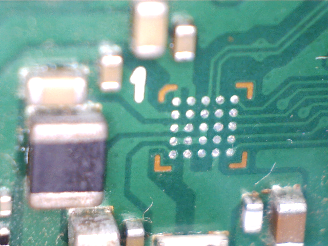

I think I found the problem... I don't know when It messed up...  :cry2:
Some advice about this component?
  • Posts: 2636
Re: No voltage for R1 Button JDM-011
« Reply #7 on: January 17, 2020, 04:53:51 PM »
I seriously doubt it's causing your R1 issue.

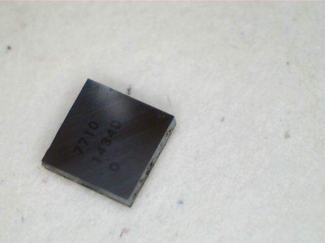

Looks like it's a TC7710WBG for charging the battery.
It seems to be the same chip from the -001 to the -020 version boards, so you shouldn't have any real problems getting a replacement one from a salvage board, or some online source, but it is a BGA-25 package, so not something everyone is really setup to rework.
This is one I just pulled from a -020 here to have a better look.
(Also have an -001 board and it's marked 7710 331A4 on that one)
There should also be no testing to see where the 8K Resistors need to go, they need to go between 3-4 then 17-18

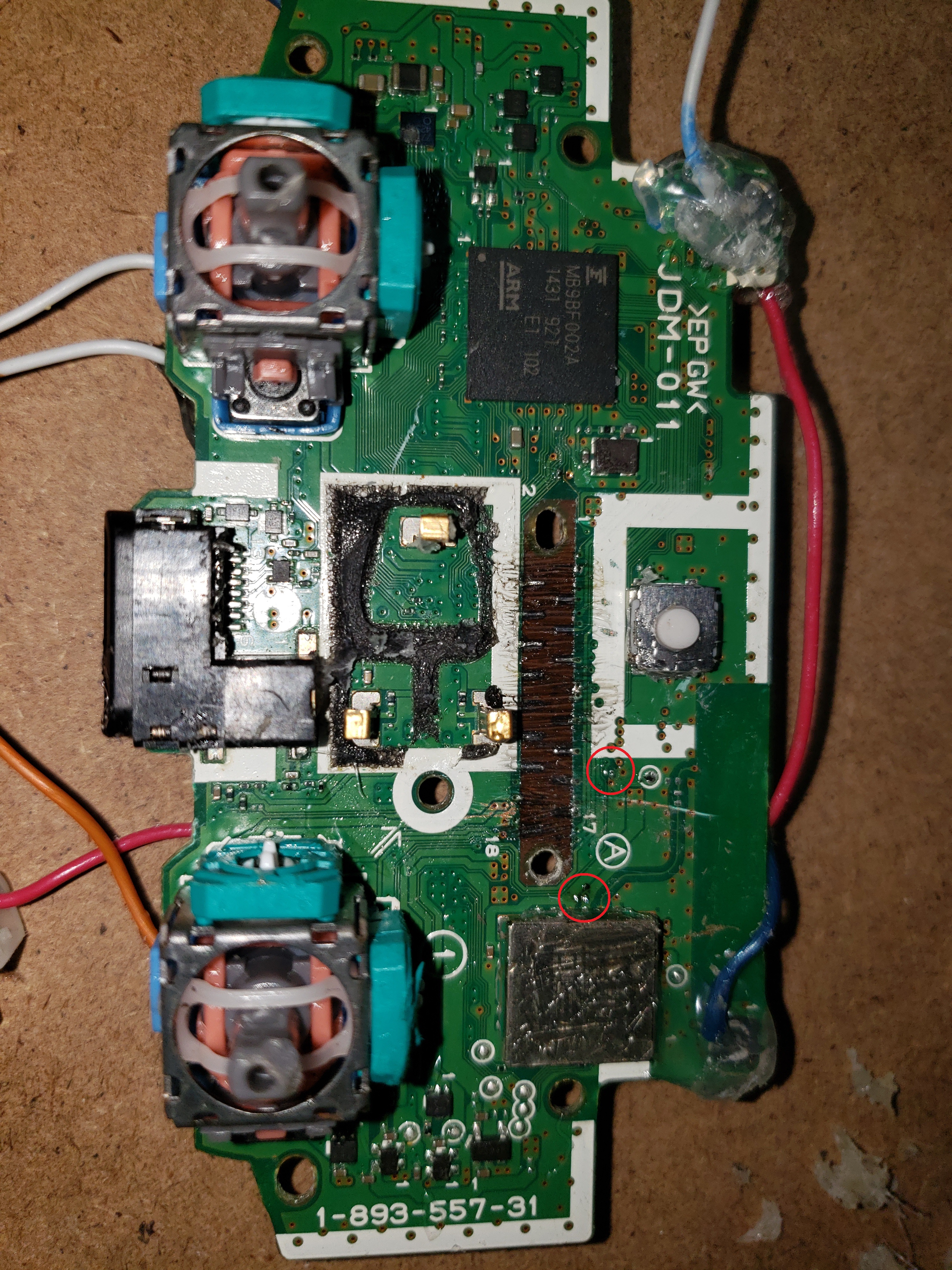

So I removed all my soldering work to find the R1 short circuit problem, but now I found that accidently at some ponit i lost 2 components.
Can I replace them? or should I give up with this board?
Thanks again...  :cry2:
« Last Edit: January 21, 2020, 02:48:26 PM by j_bogard »
  • Posts: 2636
« Reply #10 on: January 21, 2020, 06:17:10 PM »
Going by that pic, top circle should be a Resistor, 100k, 0402 size. That one you need. Bottom circle is a Capacitor and it will be fine without it.

« Reply #11 on: January 22, 2020, 05:02:42 AM »
Thanks a lot, I will install the new 100K resistor to check if pcb still working and R1 always active issue has gone.
