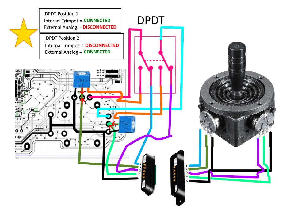

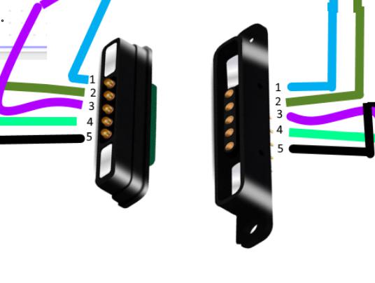

I'm doing an analog stick mod using arduino stick that looks like this.
I've connected Pins 1 & 3 to a DPDT switch to totally disconnect only 1 pin of each trimpot.
Question is do I need to use another DPDT switch for pins 2&4?
I'd imagine if its in DPDT POSITION 2, the internal pot that's connected to the board will affect resistance? Or it won't since the other side is disconnected?
« Last Edit: December 09, 2023, 11:55:26 PM by boa »
  • Posts: 2671
Re: JDM-055 (1-982-707-31) Schematic
« Reply #152 on: December 10, 2023, 12:07:28 AM »
Doing it the way you have it wired there, half of the 'disconnected' POT will still be in circuit when the other POT is, and that will give you grief.
You can still do what you're wanting there with a single DPDT, and only 4 wires at the connector. Just wire up the X and Y Axis lines of the board to the 2 Poles, then your 4 Throws will go to the 4 POT Wipers. Power and Ground can stay connected to all of the POTs all the time.
The higher the value the Internal POTs are the less it will add to the current draw when both are connected at the same time. If you are using 30k that's fine, but you could use up to 1M in there and they will still work.
You could even use a DPDT switch IC and have that 5th connector pin make it turn on/off, so when you removed the external stick it defaults to the internal POTs. That connector also doesn't look keyed, aka can only be plugged in one way. If it is not keyed and can be plugged in either way, take care with the wiring so no issues are caused there in case it's accidentally plugged in backwards.
