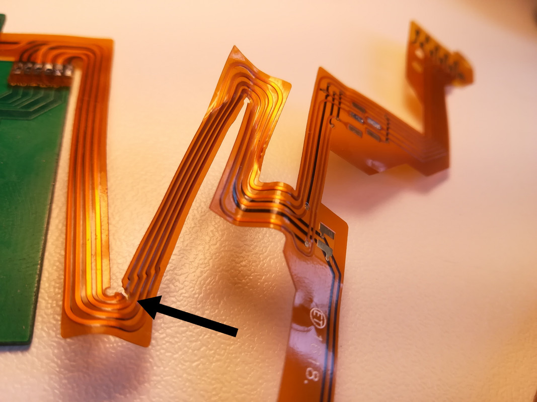

So, I bought a scuf controller with two not remappable backbuttons (X was on left and circle on right) of which the X was perfectly working while the circle backbutton only registered sometimes. I checked the circle switch and it had some small signs on it, for this reason I thought that in order to improve the contact with the metal dome to apply some tin on the circle switch (see image).
Well, after doing it both the backbuttons stopped working but the normal buttons and analogics were still fine.
Then I tried undo what I did and removed as much tin as possible but the most superficial layer, to free the copper, was impossible to remove. My question is, applying the tin on the switch was a stupid move and the reason my backbuttons stopped working?
After all this has happened I noticed that the flex board was cut where there is the ground trace (see image).
So I thought that maybe that was the real cause of the malfunctioning. So I followed the trace and I soldered a wire from the ground pin in the board to another ground pin in the flex board (btw I don't know why there was a pin there)(see image).
After doing this many front buttons stopped working except for some arrows buttons and the analogics. What I'm doing wrong?? Any help is very appreciated

Putting solder on the contacts there didn't do them any favors. They are lightly gold plated, but that's gone for good now as you'll never get the solder off it. Just clean those off with rubbing alcohol and a Q-tip if you have any issues. As far as that one goes now, best you can do is just clean it up and it should still work alright, it'll just be more likely to corrode and cause issues down the road now that it is lead/tin instead of gold is all.
Before trying to figure out what the problem is, find out where it is. First thing you should do now is take that entire mess out of there and put the controller back together 100% stock and see how it acts. If the controller isn't working correctly on it's own, then nothing you put in there is really going to act right either.

So, putting the controller back together 100% stock, the controller works fine but the backbuttons don' t work. For sure the flex cable was very damaged in some points and today I decided to cut it and recreate the traces using 3 wires as suggested. One is for ground, one is for circle and one for cross (see image).
I checked continuity with a multimeter from the switches to the final pins and there is. I did this way because I refuse to connect directly to the motherboard pcb since the bonds to it are too
weak. What I did is correct?
Well, if I do this way and I test the controller all buttons don't work but the analogs work and I really don't understand why.
