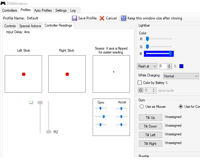

Hi, the L2 is always pressed, Ive already change the conductive film, but I think the problem is the main board, any tips
DS4windows cap
« Last Edit: June 23, 2021, 06:46:48 PM by Stackhouse »

check resistors r19 r66 r62, if not 100k ohm mcu is dead
