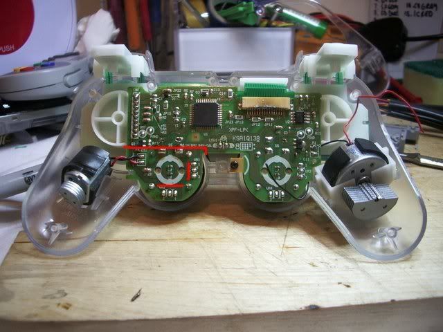

« Reply #54 on: January 12, 2007, 05:22:59 AM »
Ok heres a pic of the controller wireing. . .

Hold on, its not finished yet. I am finishing the psp wiring at the moment (its only the easy stuff left), and I dont have my mini usb sockets yet (I am gona pop into work tomorow and see if they're there).
Heres another wireing pic
