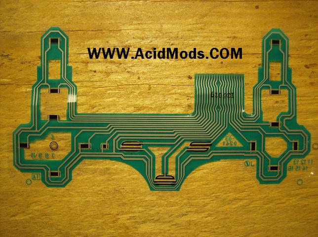

For those that might be interested
Wire chart from left to right.
1.na
2.L2
3.L1
4.UP
5.LEFT
6.DOWN
7.RIGHT
8.This ones a bit wierd its not on mine
9.GROUND
10.SELECT
11.ANALOGE ON/OFF
12.START
13.SQUARE
14.X
15.O
16.TRIANGLE
17.R1
18.R2
I am fairly sure thats right. My controller however is the older version,
 which is compleatly different. I only realized that after I finished the
 list. Grrr. I'll do another for this one.
i no this is a lil late, but im not following this........is it left to right, top to bottom? or wat

« Reply #124 on: January 15, 2007, 07:38:51 AM »
Its left to right alond the top. Why? You gona make one too?

I think your misunderstanding. I was writing down the pin outs for the ribbon conector along the top. If you folow the tracks you'll see what I mean. With me?
