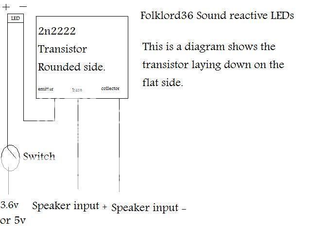

It works with an NPN transistor, as shown by FolkLord and his mod for the slim.

Wow that's sucks. My dad supports my 100% in modding. Anyway, diagram:
Actual tut for slim:
https://www.acidmods.com/forum/index.php?topic=27307.0

That picture was by folklord. But I don't really understand transistors so I wouldn't know if your thing works or not. BUT, from my understanding it wouldn't. Because you can't really alter ground can you? I mean, ground is ground. But for an NPN transistor, the voltage going into the base can be changed. I dunno I have a very small understanding of transistors...

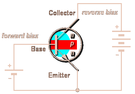

Searched around a bit on the internet and found this useful little diagram for an NPN transistor.
If you look on the homepage on the news, you should see "The new way uses a single 2n222 NPN Transistor you can buy at Radio Shack." So, we're not using a PNP transistor. That's the opposite of NPN.  :cool:
The NPN stands for "Negative, Positive, Negative". As in this diagram, the power, which is the P of NPN, is where the power is coming into the transistor. So, that power should be coming from the + of the speaker. Then there are two negatives, the base and the emitter. The emitter would normally connect to the ground, but as these are sound-reactive, they'll go to the negative of the speaker, as you need the positive and negative for them to be sound reactive. So, that leads us with the negative emitter. The emitter, hence the name, will send that power TO the positive leg of the LED. We'd probably have our resistor there. Then we should be able to connect that LED to the hold switch and ground.
So, we'll probably have to mix rceck's diagram and Folk's. In Folk's diagram the emitter is connected to the negative leg of the LED, but shouldn't it connect to the positive like in Rceck's?

I used a PNP transistor in my diagram so that it would get the charge it needs to conduct from the ground. I guess I'll just have to get some pnp transistor and try. I can get a pack of 15 for like a dollar at radioshack.

Sounds like there might be a little error in Folk's diagram.

No there is no error in his diagram. It is the + of the speaker that is causing the LEDs to turn on and off. The - is passing through the transister and the + allows it to pass.

You are misunderstood. In folklords diagram, there is no power being added to the circuit. The 3.6 or 5 volts goes straight to the led. In my diagram there is no power being added either.
Think of a transistor as a switch(because thats basically what it is). When you apply power to the base, you are not actually adding power to the circuit. Rather, you are just performing the action of turning the switch on and allowing the power to pass. From the collector to the emitter.
exactly my problem in understanding how folk did his circuit. the power has to flow through the LED to SOMEWHERE right? it's flowing to the transistor but where is it going? the speaker- is not a ground and neither is speaker+? the power is flowing nowhere thus that circuit would not work..

See thats were your problem in understanding is. You are assuming that the + 3.6 or 5 volts is flowing into the transistor. Thats where you are wrong. The - from the speaker is traveling through the transistor towards the led.

thats exactly what i don't understand, why would you tap into the +3.6 or 5v and not to ground in the first place?

You would tap onto the + 3.6 or 5 volts because the transistor controls only the - side of the circuit. You still need the + to come from somewhere and thus you use the + 3.6 or 5 volt points.
