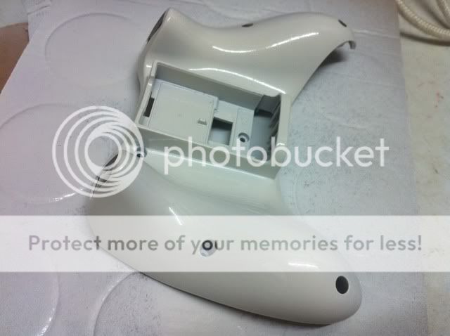

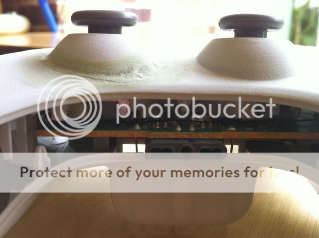

Heres my controller w.i.p, ill be updating this thread as I go. Ive started on the case, moving the left thumbstick to where the d-pad usually is.
Im still deciding on what im going to do for the d-pad buttons
pics!
Here it is sanded down a bit, I just need to fill in those little gaps around the thumbstick

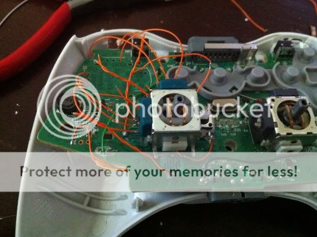

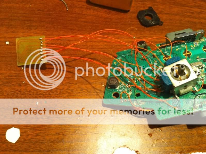

I got the thumbstick all wired up and working, ive also extended the wires for the d-pad buttons, wires everywhere!  :laughing:
now to get some paint

It just needs some clear coat now.

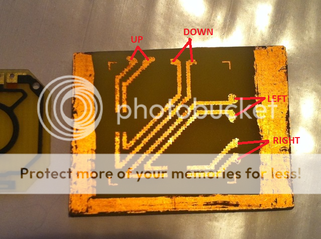

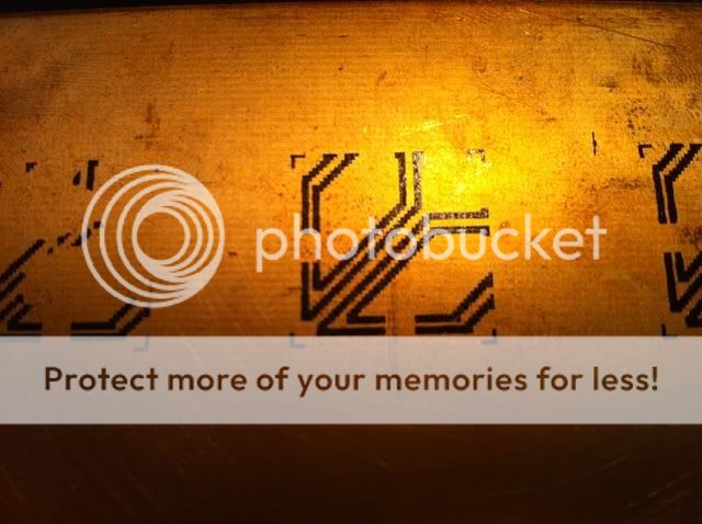

Im going to try use a psp nub for the d-pad, heres my first attempt at etching a pcb for it
my sharpie skills arent too good, the traces are off by a couple mm so it dosn't work as planned, im going to try out that press and peel printer paper so I can design the PCB on the computer and get the right width of the traces and whatnot.

thanks guys for the replies, really i dont need so much epoxi, i made two holes in my case to put two led but i didnt like it and now i have two small holes. I have seen this what do you think??:

any type of bog filler will do, i just used some auto body filler and hardener i had in the garage. ive just ordered some heat transfer paper to print out the design for the psp nub/dpad so it will take a week or two to get here from china.
still not sure how im going to mount it on the controller, i might have to paint it again afterwards.

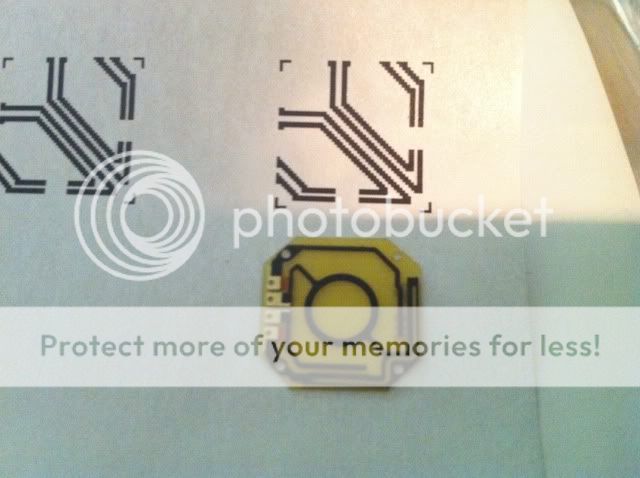

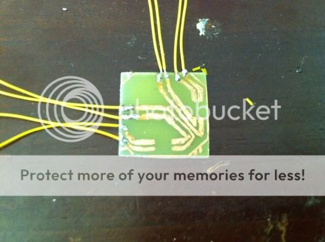

small update, i finally got round to fixing the pcb for the dpad. i still need to trim it down to size to see if it works, so here it is so far
edit: so i got it all fitting nice, soldered in the wires, but now the wires prevent it from sitting flush against the pspnub... :angry: so its back to the drawing board and to etch another pcb, im going to extend it a few mil and have all the solder pads on one side.

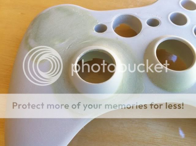

Im going to have to sand down the controller case again, as theres a small hairline crack around the thumbstick. also the clear coat i used was a piece of :censored: and i now have yellow areas all over it from a very very light spray.
it might take me a while but ill update this thread when its completely finished and looking nice.  :victory:

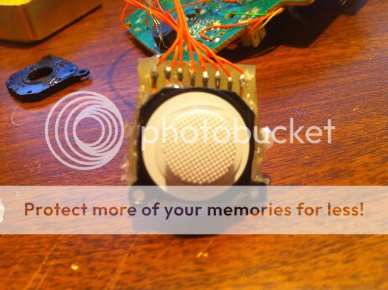

ive finally got some more time to work on this, and get the psp nub sorted.
first off, all credit goes to spurgurgle for the idea, he was the first to do this on a CG controller a while ago, im using a matrix board so its a bit different
My first attempt at this I tried spurgurgle's method using wire through the inner piece of the nub, i never really got it to work consistently so i tried a different approach
this is the revised PCB with the solder pads all on one side
here it is secured to the pcb with hot glue

here you can see the crack that formed
heres the placement of the pspnub, the hole is a little bigger than i would have liked, but it should work out after a bit more sanding.
