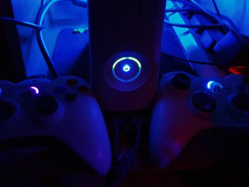

Well I havent been on in ages. My username used to be nielsss but i cant seem to recover it so I had to make a new account anway, heres a new xbox I have been working on. Oh and I know allot people have made better ones but im happy with what i've got/
Done so far;
2 strips of led's (4 LED's on each strip)
Talismoon Fans with 8 blue led's
Full Clear Case including fan tunnel
Clear dvd tray
Blue Ring Of light mod (Very hard to solder  :mellow:)
12v Fan mod
Modded controller with LED's and switch
Still to do
Get some XCM Core V2 fans
Add pulse mod
add some switches
Clear HDD case with leds
I have used respectable power sources and did not steal the dvd drive's power =]
Some pics (taken with phone, very crap quality)

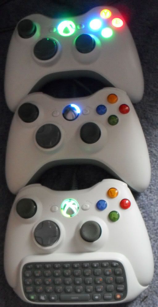

Stage 2 (Controller Mod 1)
Did not have many Pics of this :( was too eager to do Mod the Hell out of the Xbox360!! but it was basic! only the 0603 Leds were changed to UV) See above Pic!!
Stage 3 (Controller Final Mod)
This was the final Mod on the Controller! :D
And yes it is way to bright to use in everyday gaming!! lol! so now i use one of the basic Modded controllers i have!!
(UV is so much Easyer on the eyes!! lol)

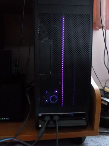

Stage 3 (console)
This was the Final MOD on the Console!! Changed the Case for a Lian-Li XB-01,
Swapped the 120MM fan for one with Leds (swapped connectors!)
Added Cold Cathode Kit (in the Base by the USB ports)
I also Changed my second Xbox360 to the Lian-Li case, But put UV Cold Cathode Kits inside (Temp controlled!!!) The hotter the console, the brighter the CC's Light up!! :D
will put pics of that up soon!! :D

Nice work - Did you drill out the ABXY buttons on the controller and use 3mm's ?
Offline Dragonspirit
  • Posts: 8
  • Modder of all thing Modable!!
Re: Official Post pics of your 360 thread
« Reply #164 on: September 24, 2009, 06:29:17 PM »
Yea, kind of!! I snapped most of the plastic bits out! then dremeled the rest out! yea i used 3mm LEDs, They are perfect for that MOD!!
I did use a Set of 0603's in one of the controller mods i did.. it looked a bit Lop sided as the Leds moved while the glue was setting :( so now i just use 3mm's!!
I also have a Controller with 3mm rainbow LEDs (Red Green Blue) with a built in IC.. That looks sweet with 4X Rainbows in the Center X!!

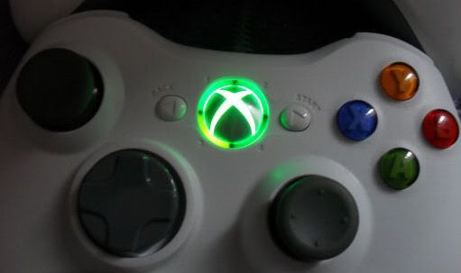

This is my Latest Xbox360 MOD
And here are some Vids i have been doing today :P
Post Merge: September 25, 2009, 10:47:26 AM
FULL Rainbow LEDs inside Xbox360 controller ROL
almost forgot to add the videos!! lol!!
My Rainbow controller!!
360 Orange Error LEDs
My Orange Error Lights!! :D

HOw did you do the Rainbow LEDs in the controller???
Looks amazing  :tup:

Thanks mate! :D
All i did was remove the Guide button, cut out the bits of plastic from the outer edge (of the inside) of the button put a little hot glue and 4 Rainbow Leds! then wire them up to the Usb 5V(red cable) and Ground (black cable).
As for the IC, its built into the LEDs!! no joke!!
and i quote:-
TruOpto >
Innovative, eye catching rainbow 3mm LEDs that contain an inbuilt IC that causes the LED to cycle through the red, green and blue elements, individually and then in combination. Colour cycles every 33 seconds.
    * Water clear or diffused lens types
    * Ideal for use in warning devices, indication panels, alarm systems, mood lighting, toys (and PSP, Xbox360, and Wii)!!!
from this site here!!
http://www.rapidonline.com/Electronic-Components/Optoelectronics/3mm-LEDs/Rainbow-colour-cycling-3mm-LED/82702
they can be bought cheaper else where but this was the first one i found when i looked! :D

put in this little blue fan
Made a vent (used the hard drive insert  for the mesh)
loaded it with 4 led's
A purple ROL (blue ROD) im going to light the window with purple leds(i think)
Hard drive out
hard drive in
yeah thats this console done for now!!
