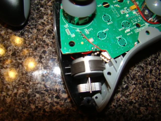

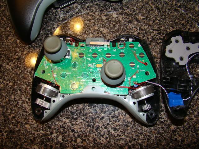

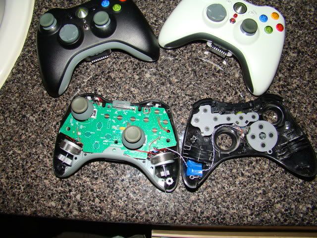

Here Picture of xbox 360 AcidMods SpitFire Mod with both Rumble it was a close fit but it can be done
« Last Edit: July 14, 2008, 09:14:57 AM by KingMike_OS »

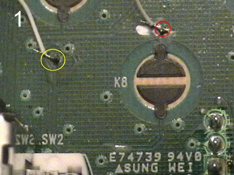

scrape it with exacto knife I/Q board than apply flux to the wire that should do the trick
good idea, thanks

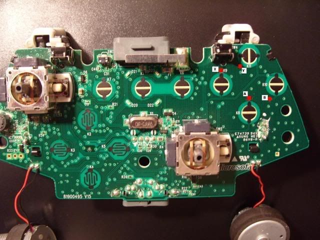

Could you do me a favour and post a picture of the back of a controller which shows where the additional buttons are? I already made one controller but im going attempt my 2nd controller as the first one stopped working, and i would like to know what the best position is for drilling the holes in the back of the controller so that the rumble fits
thanks

And i don;t know what reply 43 picture you talking about i need page number and who made the post
and the wiring is the same on wire controller just need a 100K resiter insted of the 4.7 one since the wire controller power is 5 V from the usb Port.

it is on page 2 and it was made by king mike os it is reply #43 do u have any more detailed instructions on where we put the microchip and where all of the wires hook up to
ok the top right corner the 2 picture are the same thing .. one is the digram on top and the
other is build by me so if you can see the are 5 wire ... pin 16 15 14 gose to the pic 16F84A
on the main picture and there are power and ground.
i can't make it any more simpler.  :victory:
If you doing this mod on a wired controller for the power you need a 100k Resister
Radio Shack Part # 271-1247 since the wired controller get it's power from USB and its 5V.
Now if still having problem getting the digram than send in your controller and have me
moded or you can order new kit that on a 8 pin chip only 3 wire to install and takes about 5
min it comes pre wire all you do wire the power /ground/ and middle pin on trigger and your
done. the kit is 8.99 +  shipping and come  pre wire do need to drill the hole for the switch

would it be possible to rapid fire "A" without the additional 18 pin chip. I have your programed 8 pin chip. I can get a constant rapid using the circled yellow pin but its glitchy it switches between "RB", "Down" on the D-pad and "A". I am using pin 6 from the 8 pin chip, and the circled yellow to an additional switch but its constant and cannot be controlled from the actual "A" button. So I want to add a sleeper button on off to the "A" button. hopefully you can understand what I am trying to explain. thanks
**EDIT**
I can now control from actual "A" Button, using the other "A" pin circled in red, but still performs other buttons as well (Down D-Pad, RB, A) is there a different pin?
« Last Edit: August 11, 2008, 03:11:06 PM by jhyphinwill »
