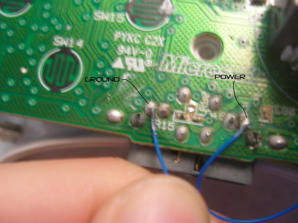

if you mean the wiring from the PIC chip to the tact switch, i think, according to others, it would be like this:
and if you mean where the ground(VSS) and the power(VDD) points are then here:
this is for wireless controller by the way, mine is a cg type board
and for the r trigger point:
- so a wire pin 1 would go to ground point as pictured
- a wire from pin 8 would go to the power point as pictured
- a wire from pin 7 and would go to the r trigger point on the board as pictured
- a wire from pin 5 would go to a 10k resistor, then solder a wire from the other side of the resistor, this wire will go to one side on the switch your going to use for rapid fire (refer back to the drawn picture)
- then solder a wire to the other side of the switch and then solder to i think pin 1 which is ground ( correct me if im wrong)
turn on the controller and make sure everything is fine, if the chip gets extremely hot then a resistor is needed, maybe a 10k one
this is what i see and would do according to the diagram, i have not done this or tested this so i do not know if it works this way, it is just a rough guide according to what i see from the diagram. anyone correct any mistakes if i am wrong
thanks
