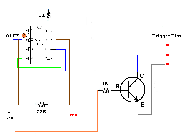

Ok after not being able to sleep and talking to mike on the phone he found a way to do the sleeper for my 555 chip.
1. take the rapid out put (pin 3 on my chip)
2. add a 1k res to it
3. wire the other end of the 1k res to the base (pin 2 of the npn) on the npn tans (middle pin) Any npn will work i used the asorted pack part nuber # 276-1617
4. pin 1 of the npn trans will go to the buttom pin of the trigger
5. pin 3 of the npn trans will go to the middle pin trigger.
sorry for the lame pin out ill will redo the tut with the new video of the sleeper working tomm. as it is 3:00am here and im half a sleep.

Ok 555 Timer Is now Works on Trigger and no external switch needed  Works & Tested Last night  :tup:
Now all we have to do add a On/off Switch to enable 555 Time and wire up to sync and you got your self
a sleeper rapid fire Kit Like Ours but from radio shack parts.
Ps: Sillynut Your Diagrams Are Hard To Fallow Let Me Help You.
Diagram Below Just a 555 Timer On a Trigger No [On/Off] Switch on it Yet for Sync.
« Last Edit: August 30, 2008, 03:46:02 AM by KingMike_OS »

hey guys, i need some help on this mod.  when i use a battery it doesnt work right and i cant click my right stick.  however, if i use my play and charge cable it works fine. what could be my problem? im thinking im not grounding in the right spot.
also to double check, does the timer go from 1 to 8 from the front or the back.
and finally which diagram should i follow since they are different.
here is a picture of how i have the pos and neg wires.
« Last Edit: August 30, 2008, 11:30:35 PM by the seeker »
Re: *** My 555 Chip with 10k pot. and sleeper added . ___With Video___
« Reply #14 on: August 31, 2008, 08:05:32 AM »
Well... look at the chip with the pins down. See the little dot? That's pin 1 right next to it. On that side it would be pin 1(by the dot) then 2,3,4 going down. Then on the right side it would go from the bottom up 5,6,7,8. Hope that helps.
Follow the one mike posted. They are the same thing except one is more confusing.
You may have something wired wrong if your right stick isn't working, check the connections and make sure you ground it to the pin that's in mikes pics for his mods in the tut section.

Ok, well i just gave this my third try... and still nothing... I wll say I'm no stranger to building components like this for several different applications, so I am pretty sure that i'm not suffering an ID10T error  :cool: hehe.  Here's what I've done so far...
attempt 1:  installed inside my controller
installed pot in handle so i could adust from outside, installed hidden switch so I could cut power to the 555 chip if i wanted to, wired up 555 according to diagram, and added the pot between pins 6&7 reassembled my controller and nothing... just normal opeation  btw on this rig i did NOT install the NPN Transistor just took pin 3 direct to ceter pin on right trigger as in original diagram.
attempt 2:
started with all fresh hardware (including a different matrix controller), built out another assembly on a cut down IC board from radio shack soldered long wires onto power, ground center right trigger pin and bottom right trigger pin, reassembled the controller and connected the power, ground center pin adn bottom pins accordingly, nada same as in first try...  in this attempt i tried both with and without the NPN Transistor
attempt 3:
again started with all fresh hardware, except controller, used same controller as in attempt 2 since i already have the 4 appropriate internal connections (properly identified i might add).  Now this time i used a project board to ensure no problems with the assembly of the chip with cap resistors, jumpers, etc. again nada... just normal controler operation.  again on this attempt i tried both with and without the NPN Transistor
I'm about out of ideas... i know i can follow a schematic and i know i can solder...  :help: please... thanks :)

island hopper, I am unsure why you are having trouble, i made this board with no problems, and this was the first board I ever made. I have made three of these now using different components and they all work.  the only thing that changes is the rate of fire, but they all rapid fire. I have done it multiple times using lager caps trying to eliminate the inconsistencies. this 555 chip drains power from the caps so fast I was not happy with it, but it does work the first time you use it, and every time just in short busts.
use mike's diagram, the best fire rate I got was without the pot at all. if you wire it per king mikes diagram make sure to put in the switching npn transistor as mike illustrates
pin #3 to base of npn, collector to middle trigger pin, emitter to bottom trigger pin
I used the mic's power source for vdd
and the battery ground for the chips ground
works every time on the new cg controllers, I have not tested it on the old controllers, I just used the push button and two wire method for them.
Just for the record, both types of 555 chips (low power or not) create “rapid fire”, but the low power chip in this configuration fires very slow more like auto fire. need to use the normal 555 chip to work the best, in this configuration. Better yet, buy mikes chip LOL
