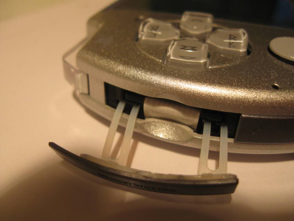

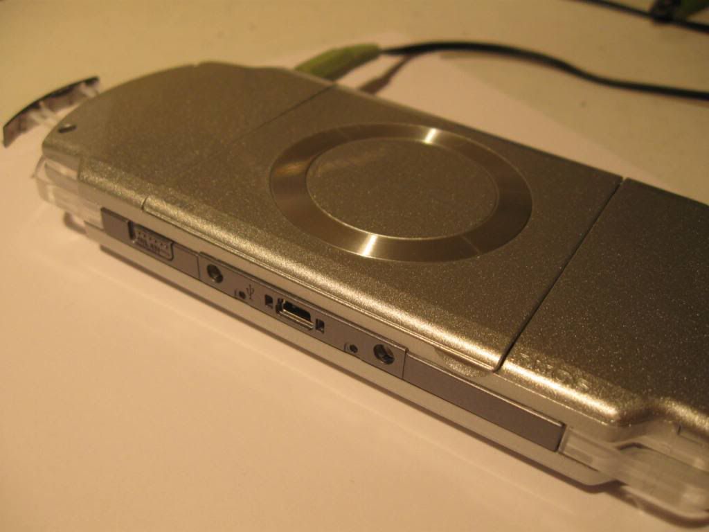

I recently decided to take on the task of internalizing a photofast cr-3100 in my slim psp.  Rather than ripping my perfectly good unit apart i figured i could buy a unit on ebay with a broken umd drive and then sell my perfectly good slim.
I found a unit for a decent price with a broken umd drive, just what I wanted.  When I got the unit I turned it on and installed 4.01 m33-2 with dc7.  I was planning on leaving the unit alone for the day, but then I went to launch a game and the unit just hung up after the white psp screen.  (you know, the one that shows up whenever you launch an application/game/homebrew/psxeboot/etc.  I figured that it was related to a dead UMD drive.  So I started the surgery.  After I finished removing the umd drive and installing the photofast adapter, I formatted the memsticks and whatnot.  But I THEN i went to launch an app, and...same problem.
There is no error message, it just hangs up every time.  I have tried multiple memory sticks and what not, all of them yield the same exact result.  I have adjusted UMD ISO mode to np9660, m33 driver, normal, etc, this does nothing.  One would say that it is the adapters fault, but this problem was occuring before I was using the adapter.
I have rebuilt IDstorage with DC7, I have formatted LFlash with DC7, I have run 4.01 m33 from the memory stick, nothing will let me launch an application.   I installed 4.01 ofw, and tried to execute the 4.05 update.  Same thing.  I tried using different cards again.
I then tried DaX's time machine, and ran 3.40 on the slim.  Same issue.  Then tried 1.50 with 3.40 modules, same issue.  Absolutely no matter what I try nothing works.  I have read about people having issues with corrupt IDstorages, but this doesn't make sense cause apparently dc7's idstorage regenerator resolves that issue.
I would suspect a hardware issue, but here's the catch.  For several hours today I have used internet radio on this unit, the wlan was constantly on and everything worked fine.  I can listen to mp3s and have the visualizer running, with the cpu maxxed at 333Mhz and everything works fine, it plays back videos, the chottoshot camera works, wlan works, everything works except absolutely no applications will launch.  The shell had never been opened (going off of the oem sticker) and there were no scuffs or scratches at all on this unit, so i do not think that it has seen any shock.  I am completely baffled by this now, I've never heard of anything like this.
Do any of you guys have any suggestions on how i can resolve this?  I don't want to resort to replacing the motherboard just yet, well at least until I understand what exactly is wrong with the unit.
Anyways, here's the pics, i am using a 8gb & 2gb microsd while my 16gb is on it's way :
