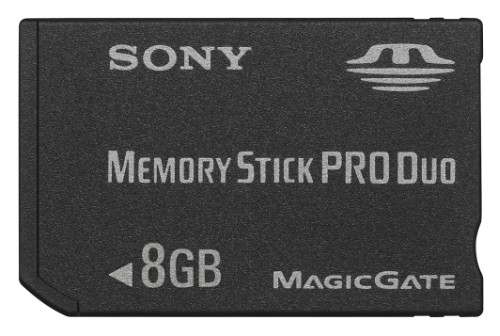

« Reply #38 on: February 25, 2009, 09:49:49 PM »
im sooooooooooo sorrybut i am still lost.
but i am trying to wire this
so this goes inside of it.........
to
so this goes inside.......
so how do i wire the first SD memory stick adapter to the memory stick pro duo adapter?
i want to build it internally but i get mixed up with where to solder :/
sorry again guys

« Reply #39 on: February 26, 2009, 04:53:33 AM »
if ur this confused u should do a little more research berfore attempting this
ur missing the microSD to MS pro duo adapter to start with

« Reply #40 on: February 26, 2009, 06:39:07 AM »
why do i need that though? :/
Re: Internal SD MOD on Slim PSP [FINISHED]
« Reply #41 on: February 26, 2009, 07:03:34 AM »
because you can't just hook up a sd slot to a ms pro duo slot without an adaptor.
