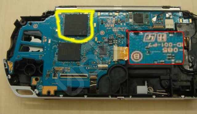

Here is a picture of were the IC is:
A temporary fix would be to put some tape on top of the IC so that when the PSP is together it pushes the IC down so that it wont lose connection.
Uhm.................................no,that would do nothing at all.
is the red the place or yellow. can some1 post a pic?
The video IC is in the yellow circle.
