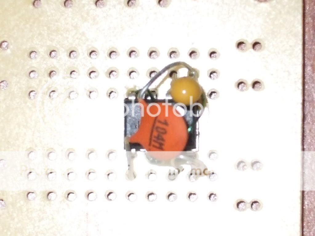

Actually cut it in half, so there are two pieces ? How come I need a board. In other tuts they just glued the chip in the dead bug position and soldered wires to the pins and then on the controller PCB.
Re: adjustable 555 rapid fire on trigger radio shack brand
« Reply #61 on: January 30, 2009, 05:40:40 AM »
max, no problem on the bump I still monitor this thread, the first pic of the board you posted is the one you want to use, that is a two pack, they are stuck together like that for packaging, in the very center you see it is kind of purfurated. build the chip in the center of one of those boards, and then cut it all down as small as posible after all the parts are assembled.
as far as whey to use the board, and not just glue the chip in and run wires, this mod is done using old logic parts, stuff you can get from a local radio shack. other chips you are used to seeing in the deadbug position, those are programed chips, these are 555 timers, the timer must have capasitors and resistors to make it do what you want, different cap, diferent affect. where as with the pic chips you get from the AM shop use a program to make the chip do what you want.
this is all outdated tech, but it is easier for beginers to do and understand, plus you wont have to order anything, everything for this mod is available localy.
another reason for the board is the timers, caps, and resistors are more heat sensitive, and the board acts like a heat sheld. I done this without the board and soldered everything just to the chip, I don't recomed this though, it is VERY hard to do correctly, and Very easy to heat damage the components

« Reply #70 on: February 10, 2009, 04:52:13 AM »
here is the deal, the first pic is of an unfinished chip, no leeds
the second chip is one I installed as I stated in the begining once you find your desiered fire rate you can swap the pot for a resistor. I have 7 controllers now. two with this 555 mod, one for each game, the others get rapid fire from a pic. with other various mods.
what is your deal. this mod works, well. what are you trying to prove?
If you cant get your mod to work it is due to your skills in following directions (or lack of) not my design, this 555 is probably the best you will find. and I am not sure if I can write the tut any more clearly.
