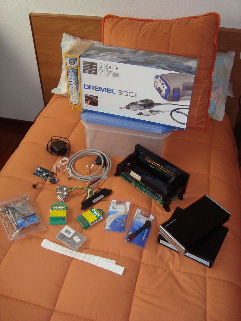

By the way, i already purchased a Dremel (99,95€). There it is:
And there is a pic with all the stuff i'll use to consolize de MVS Arcade Board :).
