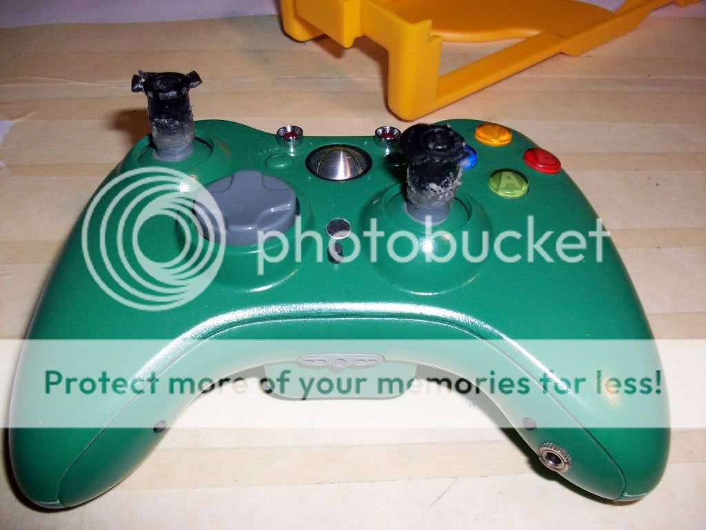

« Reply #11 on: August 27, 2009, 07:48:38 PM »

What in the blue hell is on your analogs?! >.>
they look like theyre analog sticks, that were chewed by a dog, then stuck on top of the original joysticks. this controller definitely has A LOT going on

« Reply #13 on: August 28, 2009, 05:00:17 AM »
uea, those sticks look pritty narly..mike, can you list all the mods on that controller? I see like 4 tact switches, three led indicators, a serial port...????

« Reply #14 on: August 28, 2009, 10:42:11 AM »
ya those deffenitly cant be comferatable

« Reply #15 on: August 28, 2009, 01:32:14 PM »
almost as comfortable as putting sewing needles in them and gouging them into your fingers. That way the "my finger slipped off the joystick" excuse is no longer.  :rofl:

« Reply #16 on: August 28, 2009, 08:42:15 PM »
two rumble motor leds red one for each side, Blue dome only on when controler is,1st blue 2nd red 3rd brd and 4th blue rol, middle tack program button for RF/Burst and other to tacks for speeds, RF on the trigs and internal mic with head set jak a.k.a ipod head phones. posting pic and vid on show off controler section soon
