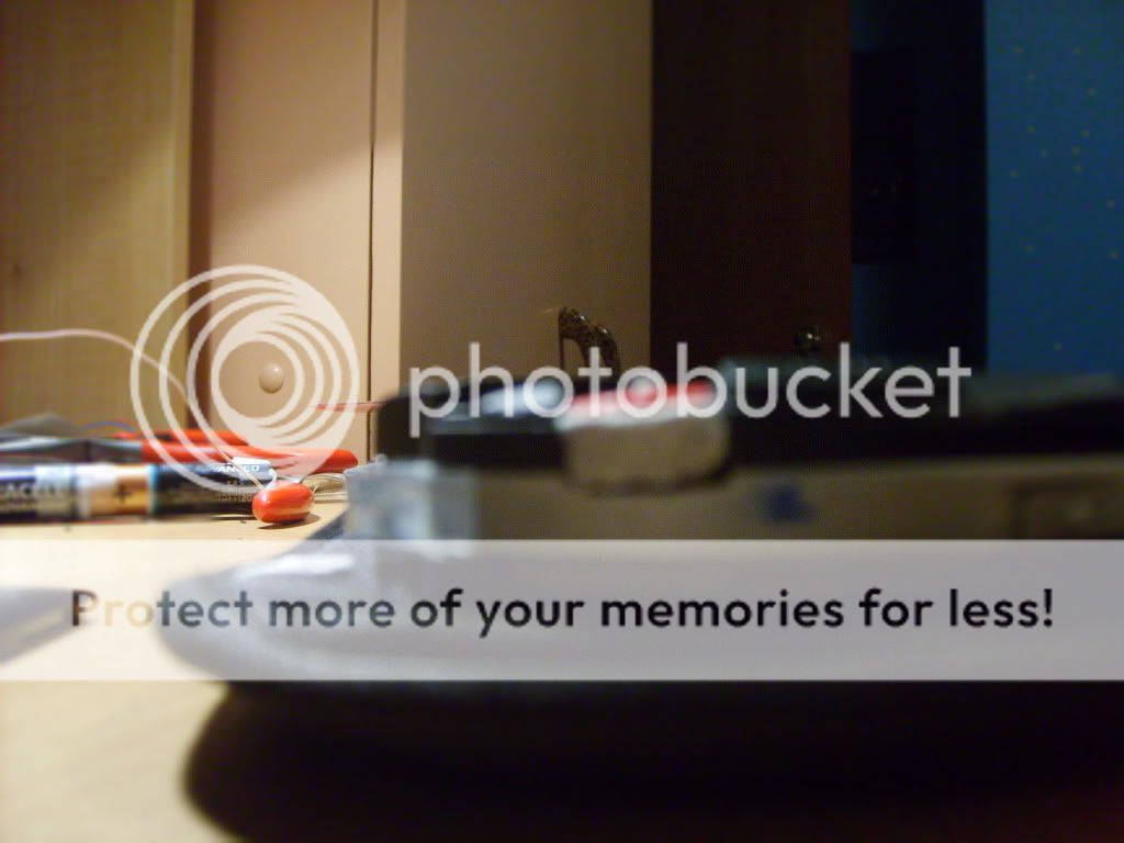

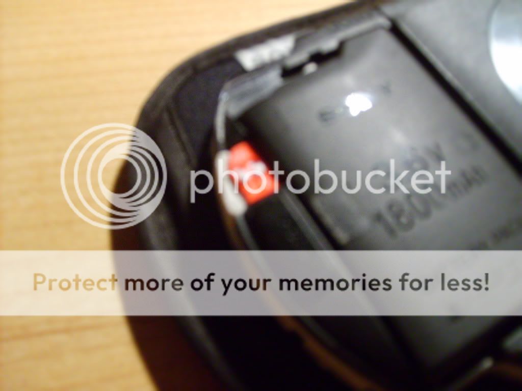

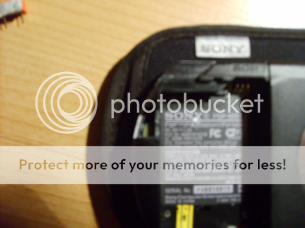

Images:
switch:
I put poster putty on the side to that it fills up the space since the switch is flat and the psp is round on the edge
USED Exacto Knifes to cut out spot for switch
