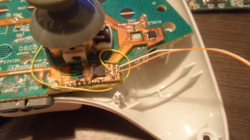

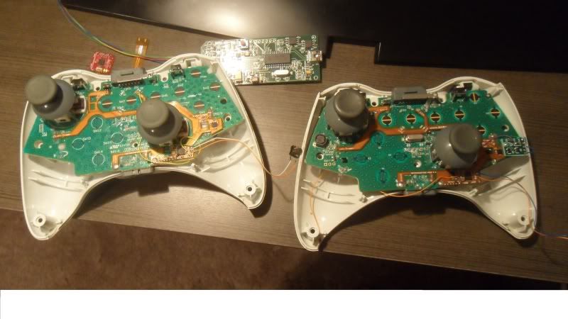

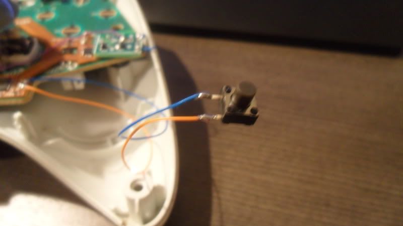

Offline KingMike_OS
  • Posts: 929
  • R&D
Re: Intensafire Button?
« Reply #27 on: June 05, 2010, 07:38:13 PM »
there is no power and ground needed ...
use one side of the butt one pin to the top pad on intensafire which is ground
and the other to the 2nd pad with is the  signal from the pic and its power from the chip
here is a picture hope this helps ..
just look at the 2 wire and the tact switch everything elase don't worry about it
did not feel like striping it down to just intensafire and butt
« Last Edit: June 05, 2010, 07:44:02 PM by KingMike_OS »

Offline crazy-modder
  • Posts: 854
  • Post quality +34/-2
« Reply #29 on: June 05, 2010, 08:36:30 PM »
Ya great pics king, what is that other little mod you got on the side?
