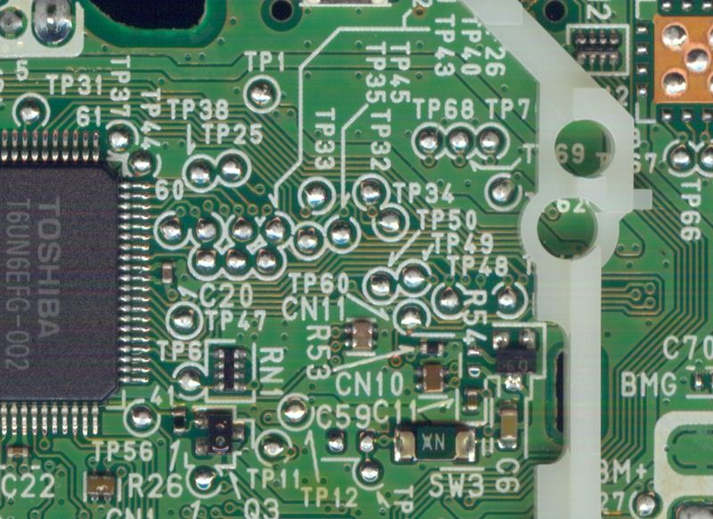

Offline rafaliyo86
  • Posts: 569
  • Post quality +12/-1
Re: Ps3 rapid fire studying and understanding project open source
« Reply #261 on: September 30, 2010, 11:37:23 PM »
wow, you have made a great job guys, hyper the connections would be like this???:
pin 1 - Vdd (+)
pin 2 - unused
pin 3 - tact switch - Vss (-)
pin 4 - unused
pin 5 - 100 ohm resistor - led
pin 6 - COM2
pin 7 - unused
pin 8 - Vss (-)
I have thsi PCB:
The point i have to use in Pin 6 (COM2) its TP26 but i dont know if its right. In this pic would be the point near TP40??
I want to test it this weekend
« Last Edit: September 30, 2010, 11:43:39 PM by rafaliyo86 »
Offline hyper999
  • Posts: 1158
  • Post quality +544/-3
  • Research and Development
« Reply #262 on: October 01, 2010, 12:22:10 AM »
Yes tht list is correct and i have some nice install diagrams for when we release the code
Offline rafaliyo86
  • Posts: 569
« Reply #263 on: October 01, 2010, 12:59:45 AM »
Thanks for the reply, i will try it in my pcb this weekend but i will wait also for your pics
Only one question more. The resistor is obligatory?? I say this becuase i want to check the code as soon as i can but i dony have resistors now and i would have to buy it lol

Offline rafaliyo86
  • Posts: 569
« Reply #266 on: October 01, 2010, 08:14:00 AM »
ok, i will put the resistor after to close the controller, to test it i dont put it.
Can you say me if TP26 is the correct point of my PCB??
Thanks hypper and matt

@matt i was feeling poetic lol and just to let you know me and system/cyberpyrot :S have started talking about the pc app
@rally here are the pics
