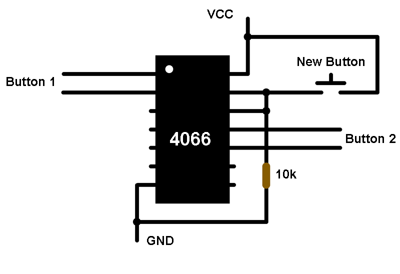

That is called Drop Shot with AIM DISABLE..  Many of the main mod makers do that.  I personally don't think it is necessary, but everyone has their preference.  I do not have an AIM disable code on my mod because I don't hook up the chip to the LT. The mod I shared with you guys here - it is very simple.  If you want to disable drop shot you only need to press sync to turn it off.  There are only 2 modes (With and Without Rapid fire) So LT aim disable is unnecessary here, but on a more comprehensive mod I can see the point.

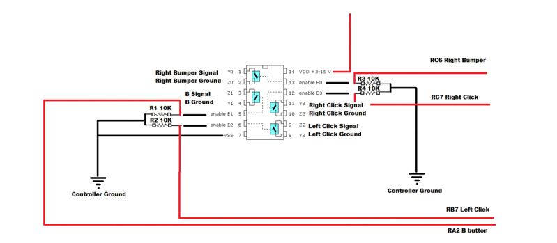

If you want drop shot on a tact you don;t even need a mod.  Let me give you guys a nice schematic that RDC shared with me on building Dropshot into any controller with a tact switch.  I use this for my customer on hard coded mods that don't have a drop shot mode.  What is great about this is it allows you to do a drop shot with the tact button when ever you want.  IF you are using an automatic weapon, the gun will still fire as normal when you press the tact but it will drop.  If you are using a semi auto weapon the tact will fire once and drop you but if you have ANY rapid fire mod enabled it will work with that mod and allow you to drop shot using rapid fire.
Here is a link to buy the 4066.
http://www.mouser.com/ProductDetail/Texas-Instruments/SN74LV4066AN/?qs=sGAEpiMZZMtxrAS98ir%252bs6Yg1tqWLu1bVp%2fTzCWw%2f6o%3d
Here is the Basic Diagram That RDC gave me.
Let me give you some hints on where to install it and how to install it.
On a Matrix - it will fit here. You will need to bend and cut the pins.  I will see If I can find an install Diagram I did.
On a CG or CG install here.
This is a pretty simple mod just requires some patience when soldering.  I have done of a ton of them they work great.

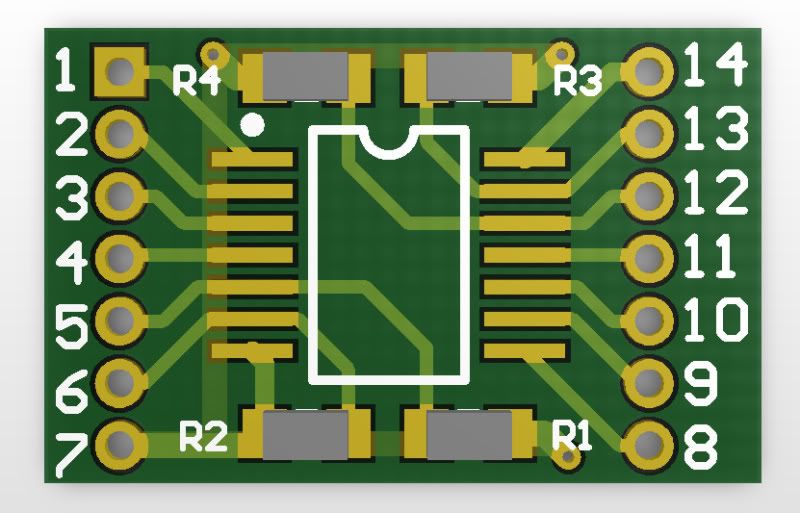

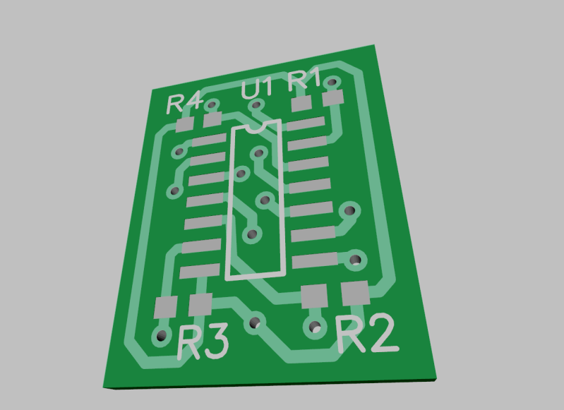

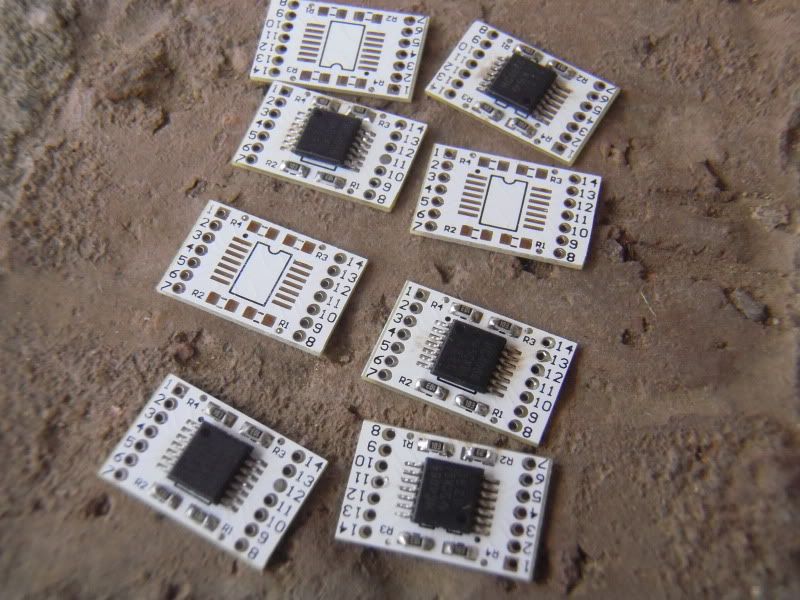

RDC was kind enough to design me an all in one board to manufacture - I never did.  I might do it though soon an offer these as easy install kits.  I wanted to use Micro 4066 with a quick solder board. Here are the prototypes RDC designed for me.

Thats Funny Was working on the similar thing same concept heheh nycxbox Beat me to it  :#1:
Also have Addon Boards that can be added to any rapidfire on the market and Give you

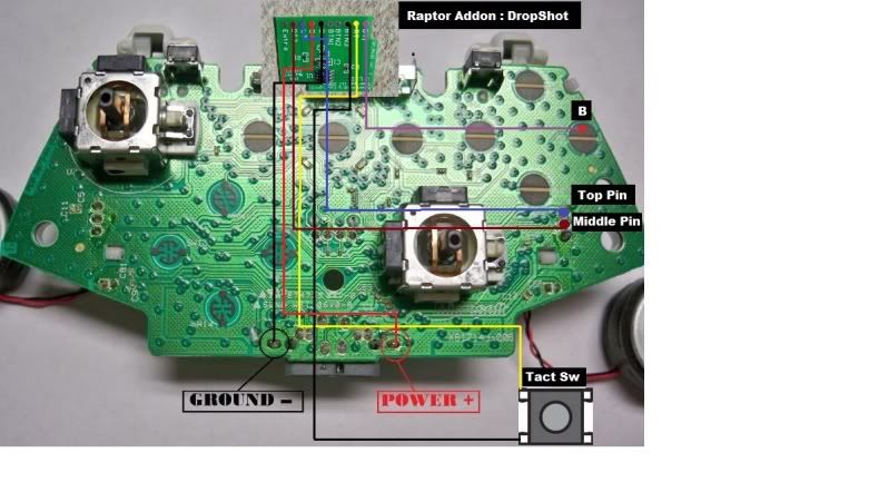

Dropshot on Tact Switch Working independently or with Rapidfire or QuickKnife Digrams Below. Rodent have few simple to play with Soon
He will right Review About it.
DropShot can work With rapidfire speed so if you have rapidfire On the gun will drop shot with Rapidfire when Tact is press if the Rapidfire is Off
Than The Gun will fire normal Fire rate when the tact is Press and Drop Shot.
Digrams Below

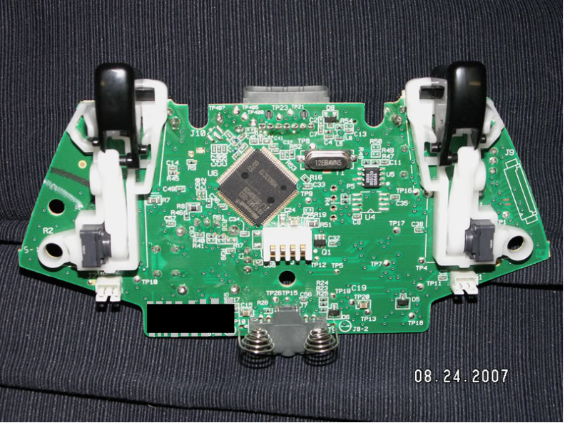

anyone have an install pic of this on a cg2?

Look at my post in this thread,  I installed it on a cg2. Just have to take the battery pack out to turn it off when the controller is off. https://www.acidmods.com/forum/index.php/topic,39929.msg313231.html#msg313231
pic is blurry

better?

Can you explain how this 4066 mod works?
I assume button 1 and button 2 stands for B button and Right trigger.
If so, why do they have both 2 connections?
EDIT: nevermind, got it working.
