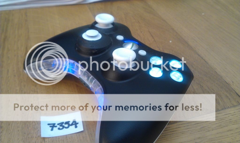

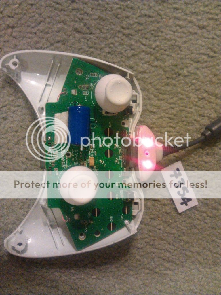

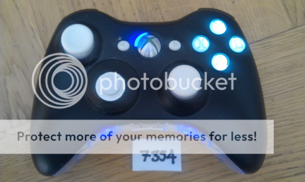

Here it is... fully functional
- Hazers Flex rapidfire
- internal 1000mah lipo battery
- PSP Analog
- t0pP8uZz LED fader
- t0pP8uZz ABXY flasher
- ROL LED swap
- ABXY LED buttons
- Modded PnC cable for Lipo battery
- 8 blue fading LED's
All crammed into a wired controller shell (no battery compartment), rumble packs are kept intact.
Silvaaa_ - AM_Modoff_final_vid.mp4
good luck to the other contestants!!

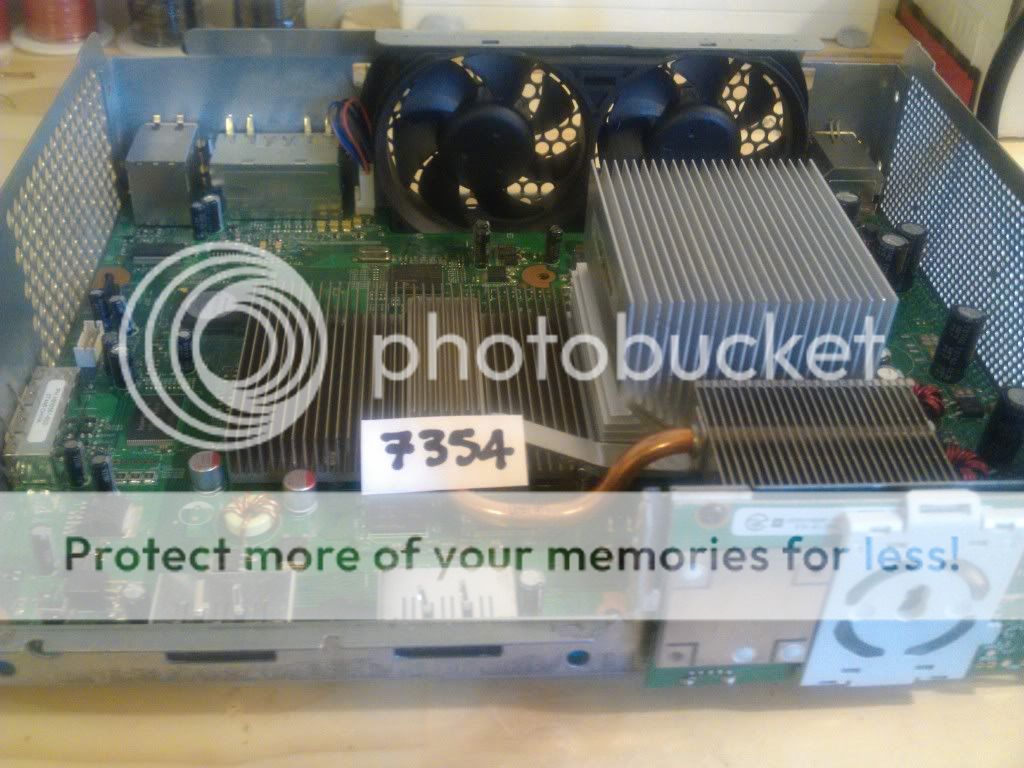

Stock Falcon 360

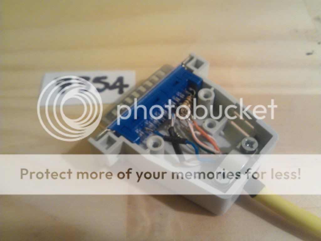

LPT cable to flash the NAND + Ethernet Jack
Tomorrow i will wire up the ethernet jack, and the JTAG wiring.

Jtag wiring + Ethernet jack wired up...
so all looks well, but its not.
I decided to plug it in and test it, before I start dumping/flashing the nand...
Plug it in, turn it on, aaaand... 3 RROD error code 0103
the fans rev up a few times, then the lights start flashing and the GPU heats up but the CPU is cold...
Tomorrow Im going to change the thermal paste on both heatsinks and put a 2nd gen CPU heatsink on the GPU, then i will replace the x-clamps if its still not playing nice.

so today i put the new heatsink on the GPU and replaced the thermal paste on the CPU/GPU
tried to boot it up and still RROD
put the 100 ohm resistor in where the jumper was
still RROD
i removed all the jtag wiring, still RROD
so it looks like im going to have to replace the xclamps, but i know those fixes never last very long.. or reflow the board myself.
any one have any suggestions? the xbox was working perfectly before hand, error code is still 0103

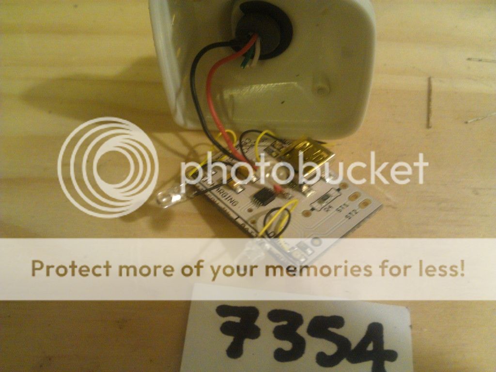

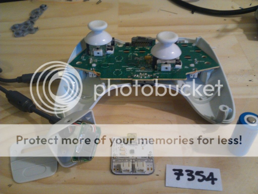

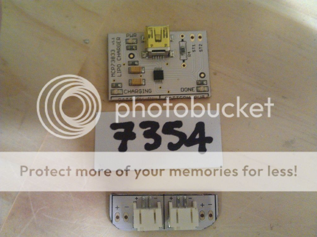

Ive started on the controller mod, here is everything i started with
I cut the lipo charger in half to fit it inside the play and charge housing
drilled 2 extra holes for the charging status LED's

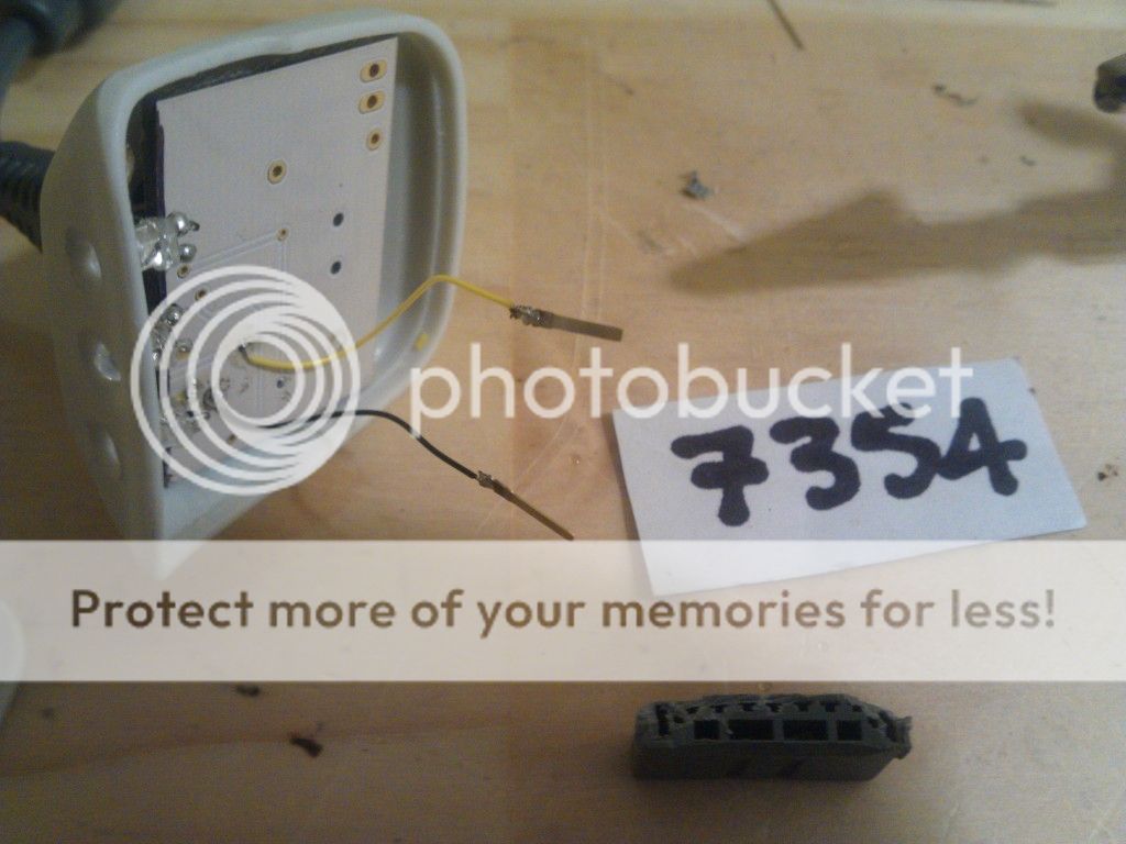

Extending the LED's
LED's superglued in place
these pins go inside the slots on the grey connector piece.
here is is all closed up
the battery is 3.6v 1000mah it takes about 3 hours to charge.
the middle LED lights up when its finished charging

big update, so far this thing has..
ABXY buttons, with ABXY flasher
blue ROL
Flex rapidfire
internal battery

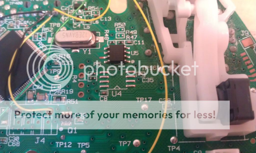

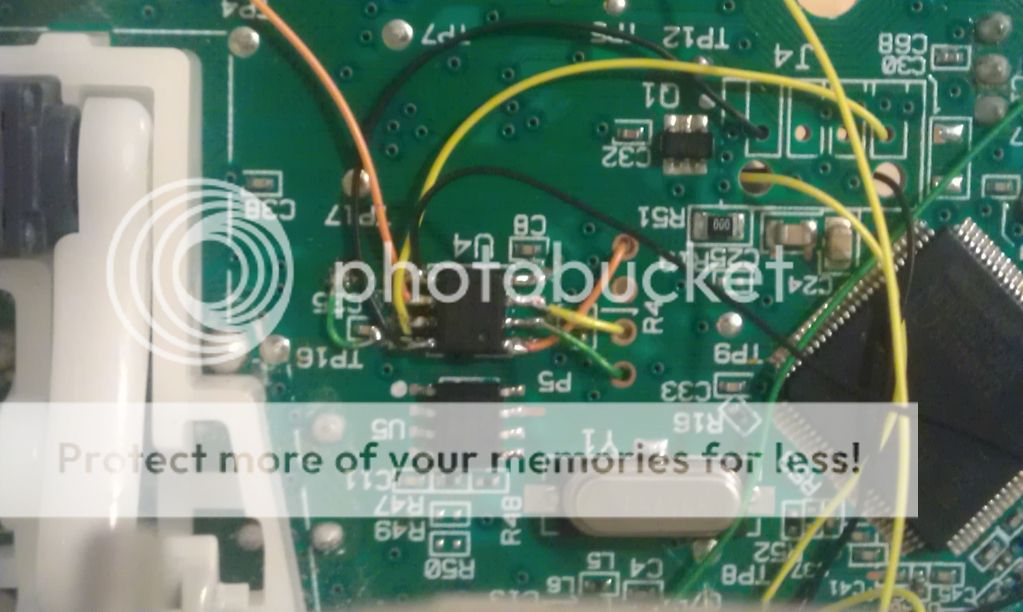

SOIC PIC12F683 programmed with Flex
Empty footprint, thank you microsoft, and thank you jrfhoutx for the tutorial
here i cut all the traces to the pads
here it is finished, it wasnt easy.
underside of controller and all my wiring, ABXY flasher top right
heres a video to show everything works, you can also see where i mounted the switch with some bondo + paint
- PSP Analog
- ROL LED swap
- ABXY LED buttons
Re: #7354 Controller Mod *FINISHED*
« Reply #29 on: March 27, 2012, 08:59:30 AM »
Awesome Job... really nice clean looking controller good luck , hope you win :)
