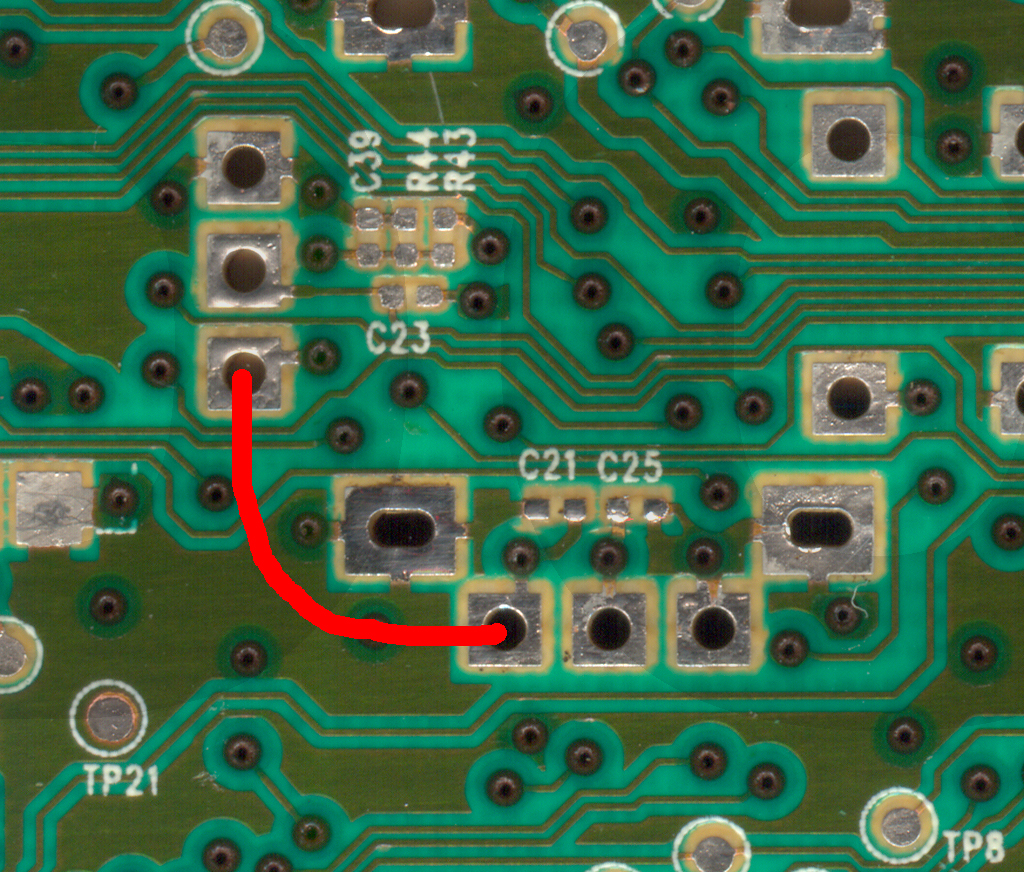

Offline nedmohm
Re: XB1 Controller PCB Scans, Traces and Info - 1537
« Reply #285 on: November 16, 2019, 08:35:14 PM »
C21 is just a Capacitor. You can leave it off the board and it will be fine with it missing.
Solder a small jumper wire as shown and it will restore the AN+ to the stick and you should be good to go.
Really appreciate your help mr. It really work like a charm, thank you for your help
« Last Edit: November 16, 2019, 08:43:27 PM by RDC »
