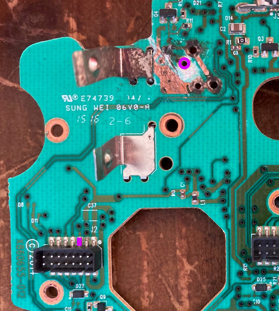

Hi RDC et ZhenyaKa, I tried the solutions you gave me, I tested by putting paper clips (because my tweezers were too big) so a paper clip with the two parts put in the bottom holes of rb and a another paper clip with the two parts in the two holes at the top of rb. When with my multimeter I test if the paper clips conduct the electricity, that works. If I put my multimeter with a tip on each paperclip, the electrcity does not flow, I do not know if it is normal. I think the problem comes from the power supply of the rb button. What do you think?

Hi, sorry for my late response, here are the photos of both sides of each card so you can see if there is a problem. As you can see the second card is in perfect condition. I did a lot of soldering because I thought the buttons I had were broken. I also scratched the green protection of the PCB to see the state of the copper underneath. Please be lenient as this is my first controller repair.  :victory:

Put a new switch in there, solder up the 3 that are still there, if they will take solder, if not all of them are ground. Then solder the last pin of it with a jumper wire to J2p5, taking care to route the wire where the shell will not pinch it.

Thank you for your answer, so I have to put a new rb button, I solder the three pins and I leave the one circled in purple without soldering, then I solder the last one and I connect the solder to the bottom connector of the PCB which is colored in purple?

Hi, here are the photos of my repair, however the rb button still does not work, I will let you look so you can tell me if you have an idea why it does not work.

That looks more like you used solder instead of wire, and if it's connected at J2 there I'd be surprised. Make sure the ground side of the RB buttons is still connected to ground also.

Thank you for your answer, I am sorry if I am not very good, I am trying to do that as best as possible. So I will try again tomorrow with copper wire instead of solder, and I will check the rb solders at the motherboard. do you think the copper could melt with the soldering iron?

Hi, it still does not work, this time I used copper wire that I soldered. I redid the other soldering of the rb button but it does not change anything. Is there something I did wrong or is the problem coming from somewhere else ?   :wacko:

That wire is way, way too large for that kind of repair, and honestly that looks worse than the solder did before. Given how the soldering is splashed all over at J2, I can't believe it doesn't have any other issues now.
It's still not past the point of being repaired, but if you keep going in that direction it's going to get harder and harder.
Remove that wire and clean all of that up with some rubbing alcohol and Q-tips and lets start over.
What are you using for a soldering iron and solder there? Do you have a DMM? Digital Multi-Meter

Hi, thank you for your reply. I will do the soldering again because it is true that it is not great. I have an 80 watt soldering iron (maybe a little too powerful), it tends to burn my solder instead of melting it. I feel like I am welding with Superman's eyes ! I use 100% tin solder. I actually have a digital multimeter. I will send you a photo later in private of my equipment to get your opinion.

If you're using 100% tin and no really good flux that would explain a lot. Get yourself some 60/40 or something around that ratio (Tin/Lead) rosin core solder.
