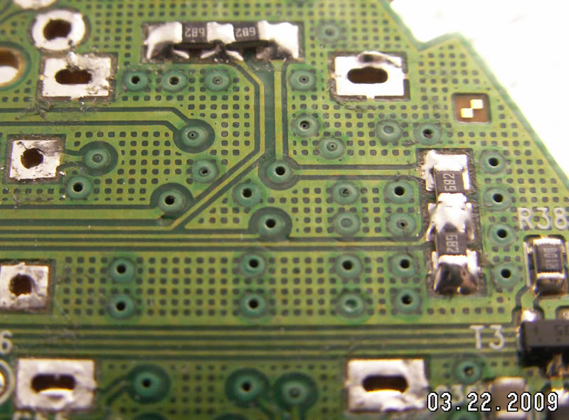

With no POTs installed the Analog lines are now floating and that will cause all kinds of issues.
360 controller shown, but it works the same for any that have the POT style sticks. Resistor value isn't super critical, just make sure they are all the same, 10k for all of them will work fine. They do not have to be SMT, they can be thru hole 1/8W or 1/4W or whatever really.

That does not help. What diagram or instructions are you using? Pictures of your install might help also.
Hello, RDC,
I am pretty new to the electronic world, can you please help me locate the left stick 10K resistors on the board?
thanks
  • Posts: 2640
Re: XB1 Controller PCB Scans, Traces and Info - 1708 "Slim"
« Reply #625 on: November 12, 2022, 07:52:44 AM »
I have no idea what you are asking for. There are no 10k Resistors for the sticks. The POTs on the sticks are 10k in value.
